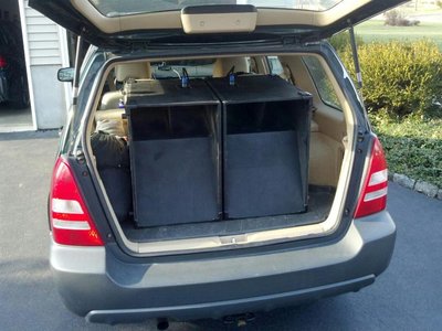

Well, the thrilling conclusion is that my new amp came, (a Sound Ordnance M1350, $90) and it works swimmingly. Swapped out the head unit, and wired up the amp, and everything worked on the first try! (never had that happen before...) Still using the OEM door speakers (which are surprisingly decent), but I have the head's crossover set at 80Hz, so they fit the sound fine. The el-cheapo amp's knobs were confusing, but I seem to have them set appropriately (HP @ 40Hz, 'input voltage' which I guess means 'gain' on a normal amp? set at ~4v to match the head's pre-outs, and some other ones I forget). No 'bass boost' or anything on anywhere.
Hooked up my multimeter, and it was peaking at 25v with the volume cranked up to 32 out of 35 max to some really heavy dubstep. A match made in heaven? I think so :) Note- it was unbearable to sit in the cabin at this point, I was using the remote control and had the multimeter wires coming through the window.
At human listening levels, things sound incredible. A little bump up in the Mids EQ, and I couldn't be happier. Definitely made the 1500 miles I drove this weekend bearable.
Anyway on to the media!

AWESOME! That's insane! Glad to see you're driving a Forester, I have a Fozzy as well. And I now know that 2 T24s will fit in a Forester.... :twisted:
But I have to disagree with you on the OEM speakers, at least for me they are awful. (2006 Forester 2.5 X 86k miles, no fancy trim or audio upgrades.)
Cool project. :mrgreen:
