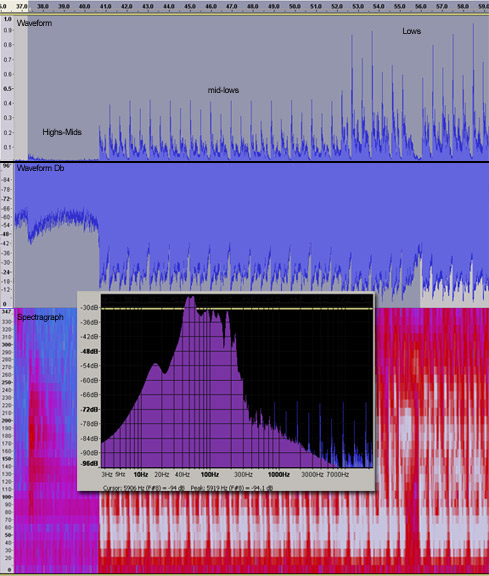

given the two major "defects" your pointing out, Bill's design is still outperforming the two Cerwin vega 18's we've used previously with higher amp levels, And I've never heard a practically flat response from 125 to 15Hz before given the "defects". The video may not sound powerful because i as a person vilify "clipped" recordings, so to compensated for the dynamic range the tuba gives out and to record the sound un-clipped, so that made me run the microphone at 25%.
so...
For the first 30 years of of 78rpm records it was a struggle between amplitude, surface noise and dynamic range. Thinking of that, Simply put, the bass is so strong when properly recorded in it's virgin state, that all the mids and highs are forced to hover in the -50 to -96 dB range. To me that's is the greatest WOW.

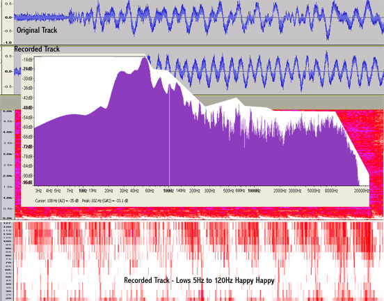

Is there a special way to record bass? The microphone recorded 50 Hz peaks with subharmonics going well below 15Hz, I used high pass fliter on the recording because nothing was usible below 20Hz(the room shaking and vibrating), there's is a 0dB peak at 50Hz,the only way to makes the bass more powerful is running a compression or limiting fliter but that's contray to the piont of the video. :?:

Lol well ragtime and techno are the same in my eyes relatives in fact,and Ragtime will always be properly recorded for full dymanic range and usable harmonics down to 5 Hz, something modern electro tech doesn't do because of industry wide practices of bad mastering and compression.I have rarely encountered a Techno track that doesn't have poor bass centering or good use of dynamic range between the lows and the rest of the sound. But I'll remaster a techno song for the next video with a spl meter handy as suggested :D thanks for the feed back.

Okay all the leaks are sealed and a 50 hour break-in done with so... How will She perform? 20 tracks chosen for historical significance and examples of bass from 1917 to 2011
With Broadcast compression "on"
http://youtu.be/KfT4lQpOa3c
With Broadcast compression "off"
http://youtu.be/BSn0oizGxFs
I'm, beyond happy
