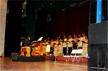

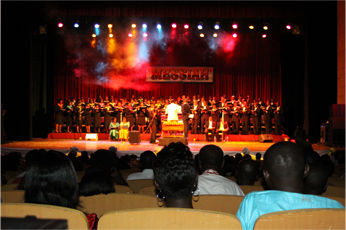

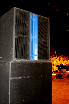

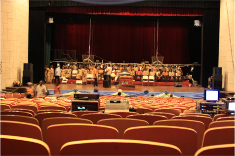

Hi folks, Here are some pictures from the gig I did on Thursday 17th Nov. 2011
- Attachments
- DR 250 T48.jpg (53.65 KiB) Viewed 7237 times
- National Theatre DR 250.jpg (60.33 KiB) Viewed 7237 times
- The concert.jpg (82.08 KiB) Viewed 7237 times
