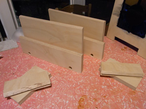

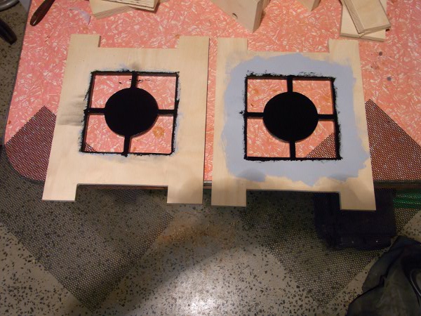

Here's all the mouth/baffle panels cut out and ready to go.
bits ready for glueing
baffles and grills
baffles and grills

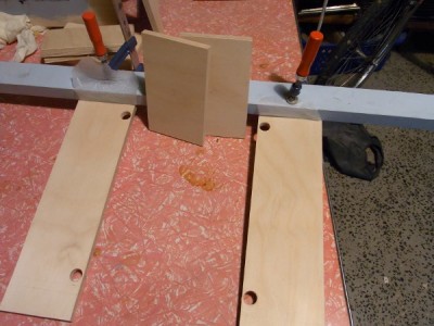

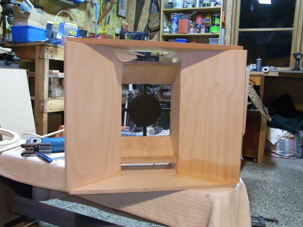

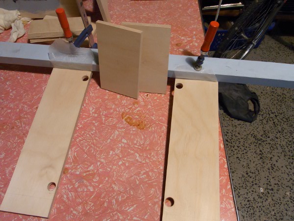

Mouth panels, guide boards on and ready to go
The guide boards above I've protected with some wax paper so they don't glue to the job. I'm using a brad nail gun rather than screws.

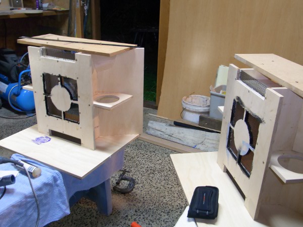

Ok, so a couple of other threads here seem to indicate that high quality finishes will just prove a source of frustration once you throw them in the back of the car a few times.
Anyway the build continues apace, more photos below. So much glue, so little wood...
I'm a bit concerned about the next step, getting the top on to cut off the excess mouth panel. Not sure whether to nail and glue it before doing this, or just to hold it in place with clamps.

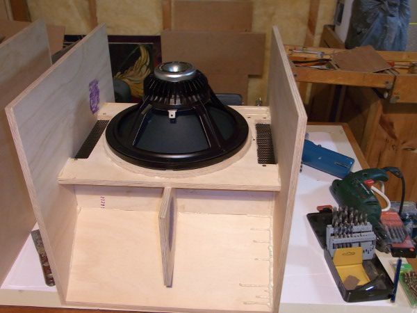

So I was trial fitting the drivers today and wondering about a couple of things.
How tight should I compress the gasket? I guess it just needs to be airtight.
Should I be removing the rear gasket so that I can screw down directly onto the speaker frame or just be leaving it there and compressing it?
I'm really happy with how the tops went on, the sides seem to be totally square so it should just be a matter of clamps and glue now... then the hardware.
Trial fitting the drivers.

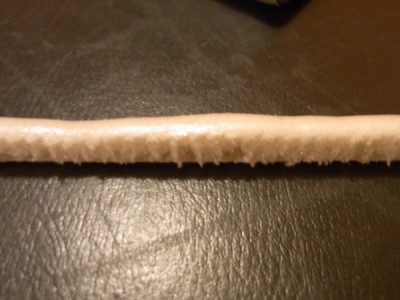

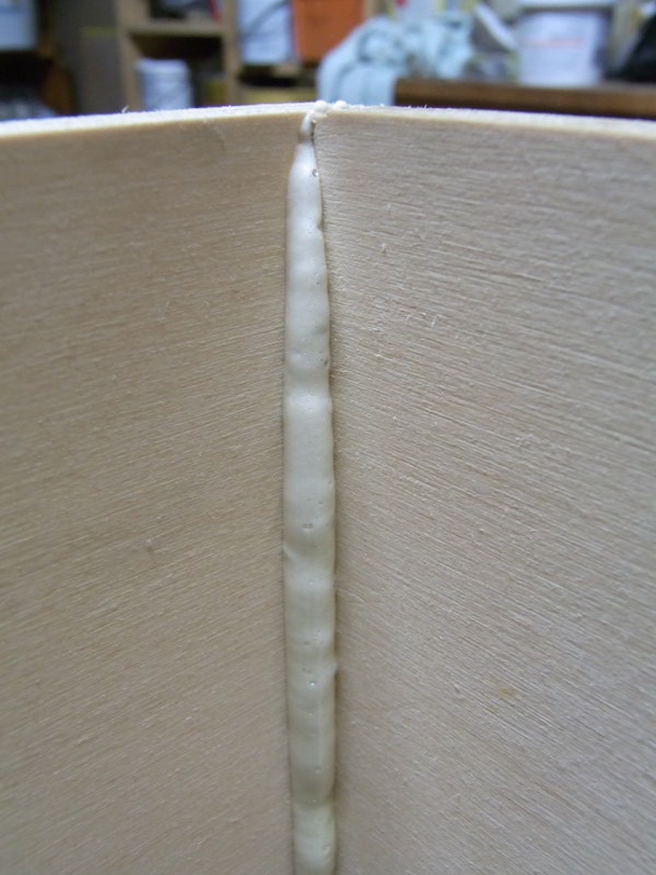

Too late, I glued the sides on last night. Here's some pics of the glue, one from where it's still in the join, the other from a piece that I took off with a scraper.
Here's a link to some info on the glue.
http://www.titebond.com/ProductLineTB.a ... prodline=6
and the pics... if anyone has any opinion I'd be grateful to hear it, although at this stage I'm thinking that I might as well get the drivers in and test for leaks regardless.
This is what it looks like once it's been scraped off. Note the honeycomb bubble effect that it gets on the inside.
Here you can see how it has expanded out of the joint.
Re: 2 Jack 112s
#14 Post by LelandCrooks »
Don't use it on subs.
