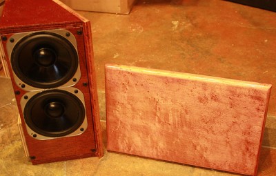

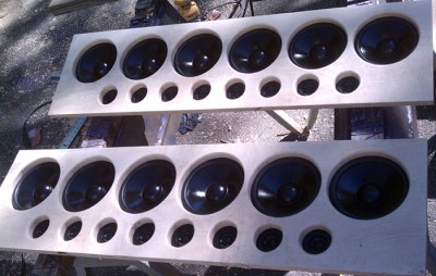

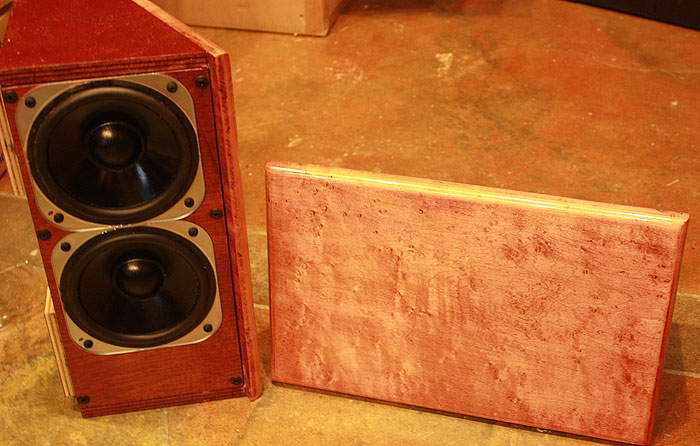

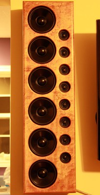

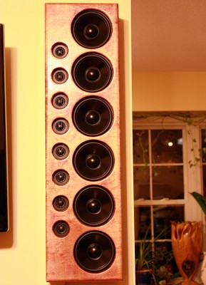

I built these using the clearance Sony speakers from Parts Express and Goldwood GT-302/S tweeters. The fronts are solid Birdseye Maple (looks great but hard to work with). The rest is 1/2" Cherry plywood. The tops are really nice so I made the back removable instead of the front.
I should preface this by saying I'm very picky and spoiled when it comes to sound. I own a recording studio with a very nice 500sf control room. The room is well tuned and has soffit mounted surround speakers. I spend a lot of my time mixing. Some music but mostly post-production.
I have my SLAs hooked up to my HTPC through a Onkyo TX-NR509 receiver in my living room. When I first hooked them up I thought they sounded alright but a bit to bright and a little honky. I didn't have the Onkyo when I first hooked them (as it was on order) so I had them hooked up to a Crown XLS 402 power amp. I played around with an EQ for a bit and after I broke them in for a few days they started to sound good. After I received my Onkyo I ran the Audyssey EQ program and now they sound awesome. Music is very clear and detailed with out sounding harsh. Movies are great, very full sound without the dialog getting lost. I could easily mix on these and am seriously thinking of building a set for the studio. I am very impressed with the SLAs (and my new receiver). Another great BFM design. Easy to build and they sound great. I was about to order more Sony's but they have sold out :( Lucky I ordered enough to do rear speakers and a curved center. Also going to build a TAT sub to complete my 5.1 system. I'll post reviews when I finish my other speakers. Working on ceiling firing rears (that sounds disturbing :shock: ) at the moment.

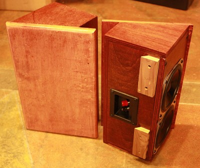

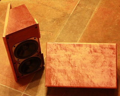

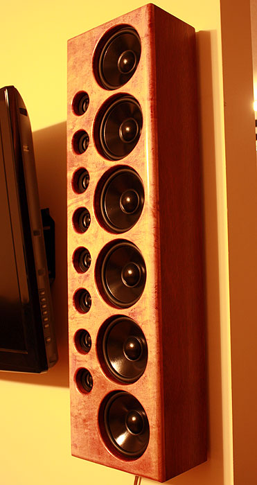

Another picture...

Nice work. A hint: the indoor pics are color affected by the artificial light. Try altering the overall color tint, you should be able to get them to look a lot closer to the true color seen in the outdoor shot.

That looks great, nice job. Too bad those Sony drivers aren't available anymore, you probably can't find much of anything that's better for the price.

Bill Fitzmaurice wrote:Nice work. A hint: the indoor pics are color affected by the artificial light. Try altering the overall color tint, you should be able to get them to look a lot closer to the true color seen in the outdoor shot.
Sadly I did adjust the color but I took these at night without a tripod. They were very red to start with. I'll take some better shots it a bit.

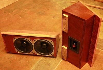

I just finished my rear surrounds. They are inspired by the ones Brew posted in this thread. http://billfitzmaurice.info/forum/viewt ... ds#p151540
Fronts are birds eye Maple the rest is Cherry plywood. I left room in case I want to add a tweeter. I think I am going to install a light in them so they just look like a light sconce. Like my SLAs these will be hung with a French cleat.
Next up is a curved SLA center. I am building a entertainment center to go under my TV. It will house my center and sub. I'm doing it out of Cherry plywood with Tigerwood edging. I think I am going to do my center out of Tigerwood to match.
