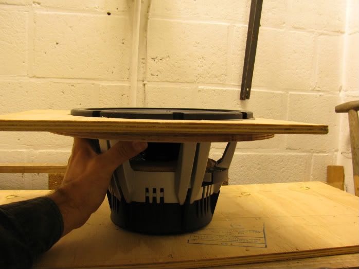

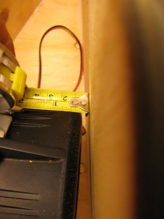

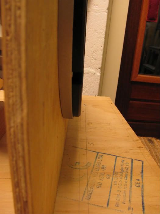

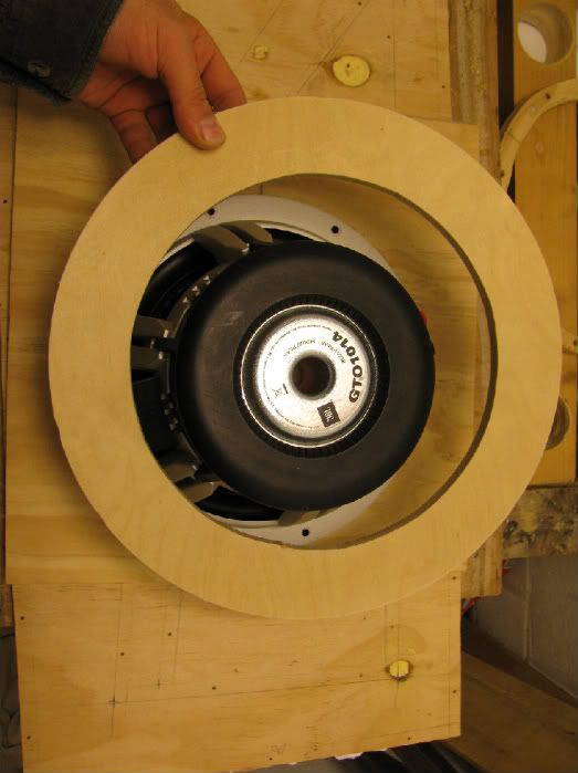

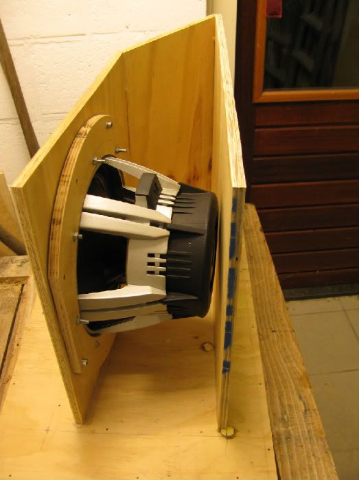

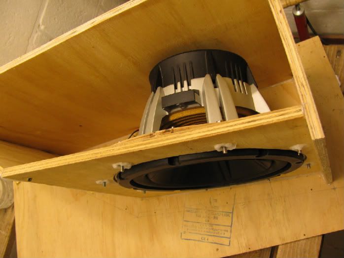

Shame I didn't see this earlier. I also used a JBL GTO1014D. Didn't alter the plans though 8) . Here's a couple of pics how I fixed it:
This is obviously not going to work. No room for the speaker to breath:
So let's try another approach:
It fits :hyper: . ...barely :shock:
It'll never come out, though. but since my 130W car amp will probably never fry this 850W RMS woofer, I'll took my chances. It has been in my car (a Volkswagen Passat station) for about two years now and I have no complaints. Lowpass 80Hz, no HP. Compared to the 740P (sold to a friend) this speaker doesn't bottom out as fast with very low frequencies.
