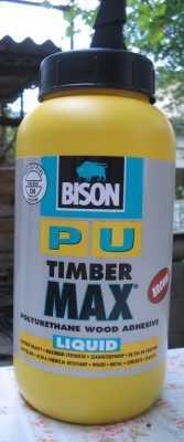

PL is simply not available here, but I just bought Bison Pu Max Timber liquid polyurethane adhesive.
"1-part polyurethane adhesive, which sets hard under the influence of atmospheric and/or material moisture. "
Sounds same as PL, I've been through technical datasheets of both adhesives and they have similar properties. Bison is renown adhesive brand here in Europe... I hope this is suitable substitute for Loctite® PL Premium® Adhesive.
If anybody have some experience with this adhesive, it would be comforting to hear about it.
P.S. Will 1 bottle of 750g (26.5 ounce) suffice for THT box building?

PL doesn't set hard and is thicker like caulk so it's better at sealing joints. The bison should be plenty strong - just take care to make sure it seals everything well. Can you get the Liquid Nail poly there?

I've tried that stuff and it's a recipe for leaks.vann wrote:PL is simply not available here, but I just bought Bison Pu Max Timber liquid polyurethane adhesive.?
The problem is that it seeps away from the joints being honey like in consistency. You have to have the joints dead level.
It's almost impossible to guarantee a leak free joint all the way along.
I know you said PL is not available where you are but surely you are able to get a PL equivelent from somewhere or import it from the likes of Leland at www.speakerhardware.com.
It does not have a dangerous goods classification so it can be shipped anywhere.

Unfortunately no, I guess it's an US brand.Greg Plouvier wrote:PL doesn't set hard and is thicker like caulk so it's better at sealing joints. The bison should be plenty strong - just take care to make sure it seals everything well. Can you get the Liquid Nail poly there?
Even if Bison sets hard it's still polyurethane and listed as having gap filling properties... I guess it should still be much better than standard carpenters glue, polyvinyl acetate (PVA)?
Damn... if possible I'd really not import adhesive, as my budget is already broken I already bought this (was the most expencive wood glue in store)Harley wrote: I've tried that stuff and it's a recipe for leaks.

The main issue is getting a perfect seal when applying the second side. With PL it's no problem. If an internal joint does leak you can't get at it to fix it.

As an alternative, at least for the last side that is the biggest problem because it's uncaulcable, you could try to use PU insulation foam in a spray can. It expands pretty well (like 5-6 times
). Not sure about the strength, but combined with brads or screws it should be good. It's probably a bit difficult to control the amount, however.

Sorry but that's that's definitely a no-no. It has very little boning strength. Sure it sticks to surfaces like baby poo to a blanket, but it's not an adhesive - it's a gap filler.Rune Bivrin wrote:As an alternative, at least for the last side that is the biggest problem because it's uncaulcable, you could try to use PU insulation foam in a spray can..
Expanding 100% polyurethane is an adhesive which achieves its strongest bond through compression ( claps or screws ) and moisture during the curing process. Because it expands, it fills any small gaps so it acts like a gap filler for those situations.
Even if it could act as an adhesive, PU insulation foam has far too greater of an expansion rate and for what we do, it's uncontrollable.

I've contacted Bison's tech support with inquiry about this adhesive's expanding (gap filling) properties. And asked if there is any other adhesive from Bison that meets my requirements better than this particular adhesive.
