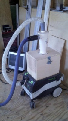

Here's what I use.....

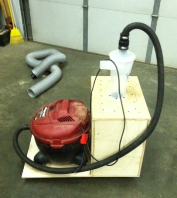

I use this with both shop vac and a harbor freight dust collector.
http://www.cgallery.com/jpthien/cy.htm
I use the second overhead collector on this page:
http://www.kevinsbrady.net/DustCollection.html
