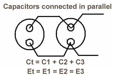

Are you able to get two 10uF caps, instead? Or one 15uF and one 5 uF?

I live in Ghana in West Africa. I was told by the vendor that he has the 10uf. How do I use that?

Connect them in parallel.

Do you know how to connect them in parallel???
This is parallel And this is series get a good clean solder on them.

Thanks guys, The project is turning out great I'll soon post my pix.
