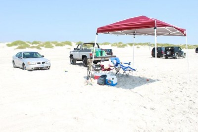

Found a picture. It's the little green beast on the tailgate.
I'm sure the 80W amp would drive this thing to deafening levels, but the whole idea was to make a cheap tailgate/party rig. Did it all for under $200 and I can't imagine needing a bigger amp. If anything, I'll just build another box and stack em if I decide I need more volume. Should work just fine with just the little Lepai.
