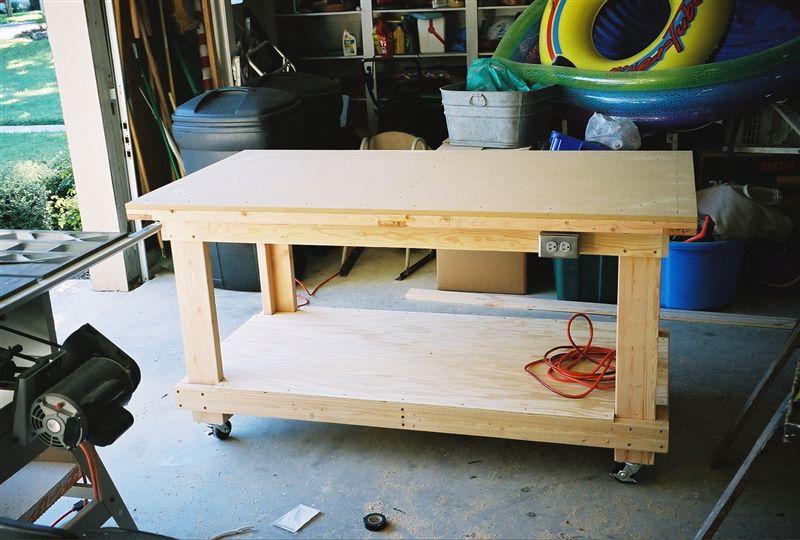

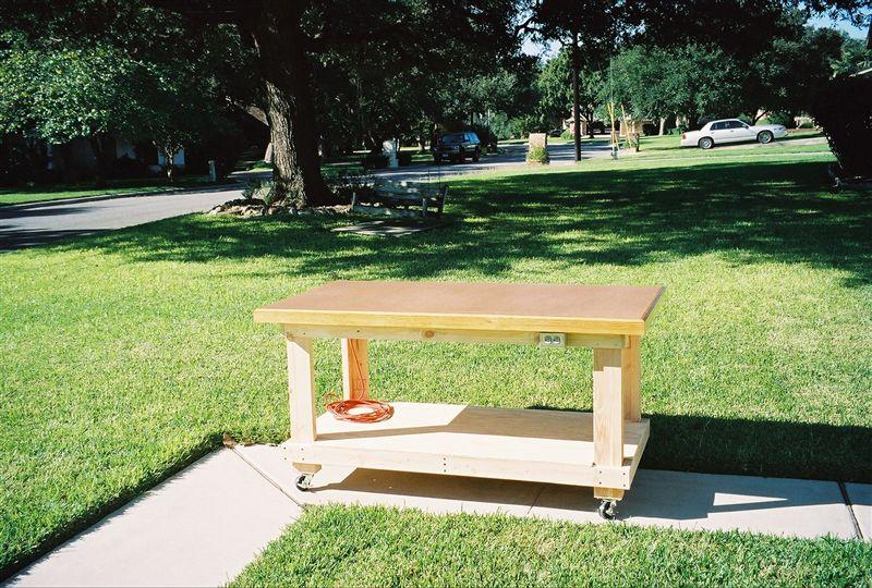

Use MDF. It's heavy and absolutely flat. Two pieces of 5/8 or 3/4 glued and screwed together will make a great surface. Add a piece of cheap fiberboard for a replaceable top and you got a great work surface. Here's how I did it on my workbench. I absolutely love it - I should have done it way before I did.
Re: laminating multiple large sheets of plywood
Exactly what I did - double layer of MDF with a piece of masonite on top. Trimmed out with poplar around the edge with a 1/4" lip for the masonite to fit in. I drilled out a 3/4" hole at one end so it's easier to pop the masonite off when I need a fresh face.
