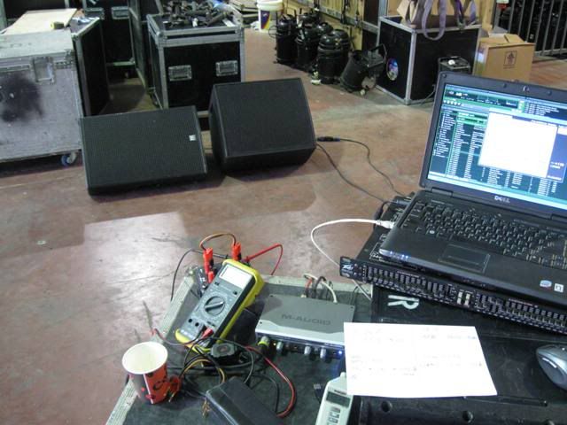

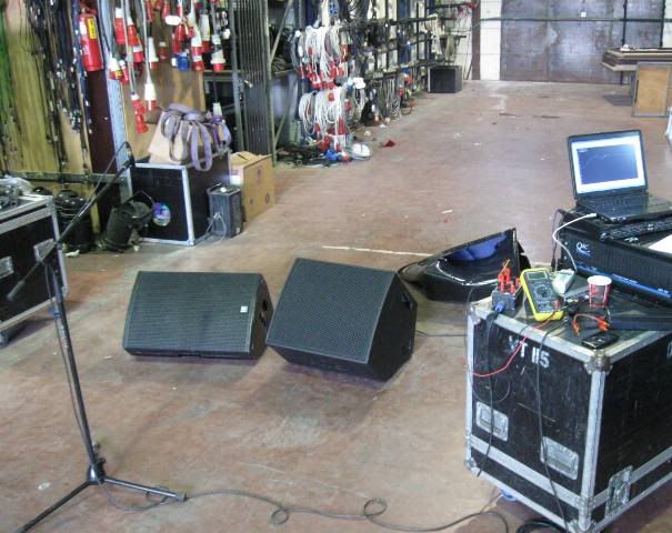

The test setup consisted of a Laptop PC, an M-Audio Solo sound interface, a DBX-M measurement mic., a QSC USA850 Amplifier and the Galaxy Audio CM140 SPL meter.
The test was performed indoors, in the middle of a big warehouse but full of equipment and stuff so no meaningful reflections or reverberations were noticed.
Both monitors were positioned on the floor in their 'natural' work position and the measurement mic. placed on the cab's output axis, one meter from the front grill
(alternately moved between the cabs). The SPL measurement was taken by placing the CM140 next to the mic's position.
Here the setup:

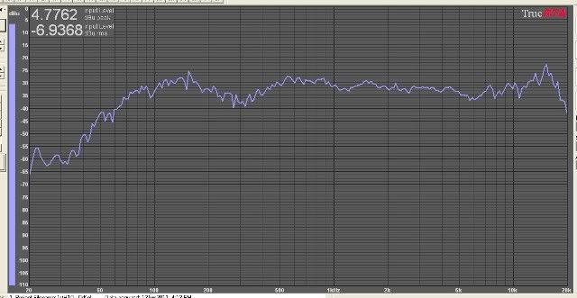

First in line, the HK CT115:
True RTA software, fed pink noise directly from the sound card to the Amp. and on to the cab. The measurement mic. connected directly to the soundcard.
This is the response curve of the CT115:
From the plot, I chose the 150Hz peek as the frequency point for the test.

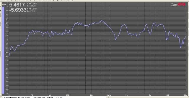

Next, the same procedure was run on the WH10.
This is the response plot of the WH10.
For the maximum efficiency test I picked the 800Hz peak/point.

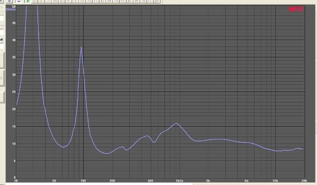

And here is the impedance plot of the WH10:
From which is seen that the impedance at 800Hz is 8.5 ohm.
The calculation says 2.9v needs to be supplied to the cab to produce 1w.
So next, 800 Hz was generated and measured to be 2.9v on the cab leads.
The SPL meter at 1 meter red 104.6dB :D
Listening test:
The wedges were placed side by side and connected each to one side of the Amp, like so:
The CT115 channel got the signal directly from the sound card. The WH10 channel went through a 2/3 octave EQ,
with only some basic corrections applied in order to match the apparent SPL and tone to that of the CT115:
the overall gain was reduced by 5 – 6dB and some moderate attenuations were set at 600 - 800hZ and at around 6kHz,
as these peaks were really standing out.
