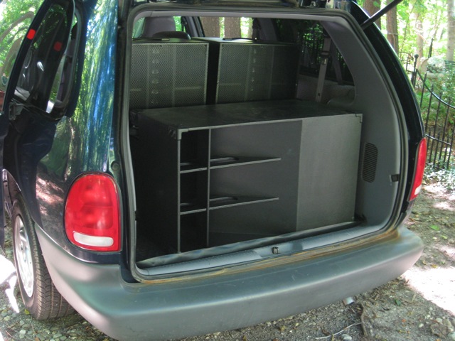

Here's my T39 (23.5"), with my DR200s sitting on the folded back row.
BASS: Combo Amp & Titan39

Hook it up. You can call it your AutoTitan.Gauss wrote:Here's my T39 (23.5"), with my DR200s sitting on the folded back row.

The van looks full... wait a minute, folded down back seat? Yank that sucker out of there. I have both rows of back seats stacked up in the garage for now, but they will finally see use in a couple of weeks as my dr builders break lounge in the garage.

I shoot for efficiency, so no need to get the max space from the van. I throw a rack and cable bin on top of the Titan, slide the stands in the left side and call the sound good. I haven't needed more than I have yet
The lighting and table goes in the front row. My needs are not everyone's but it has worked for a variety of situations (junior high gyms, charity car wash, and wedding receptions.)
When I pack for my friend with the JBL dual tops and dual subs, we take out the seats and fill it up. He packs a lot more, including a 24 channel mixer in a flight case. I may try standing the Titan up now that SeisTres mentioned it.
My seats are really heavy, so I hate pulling them out. Plus, I don't have any good place for them -- I only wish I had a builder's lounge, I did most of my construction at the neighbor's and other people's houses.
