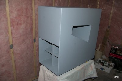

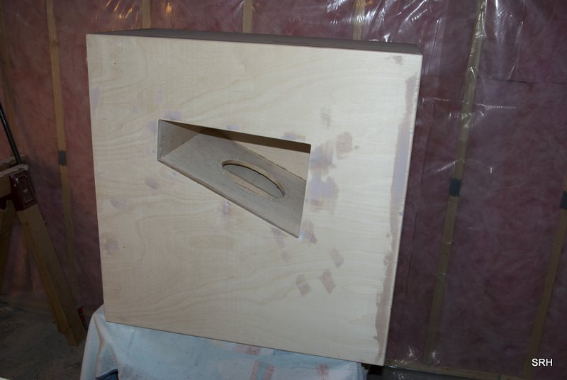

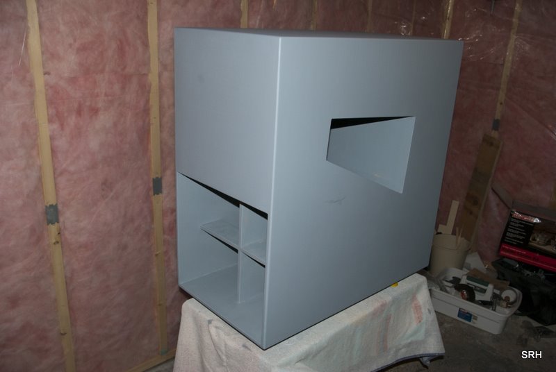

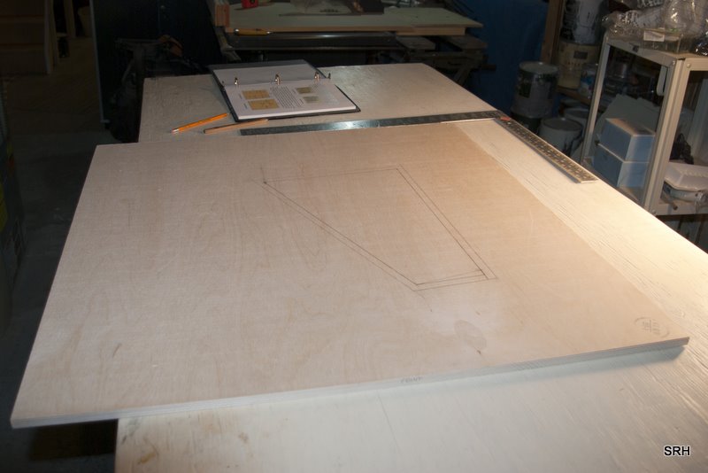

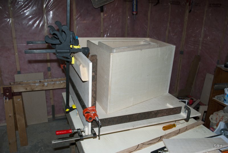

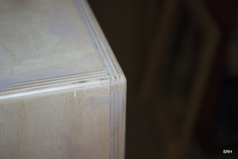

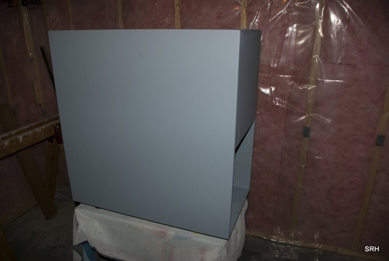

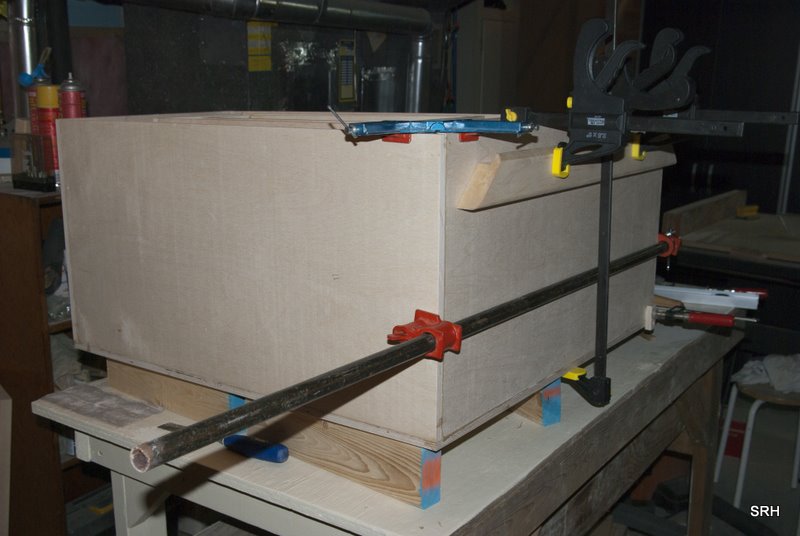

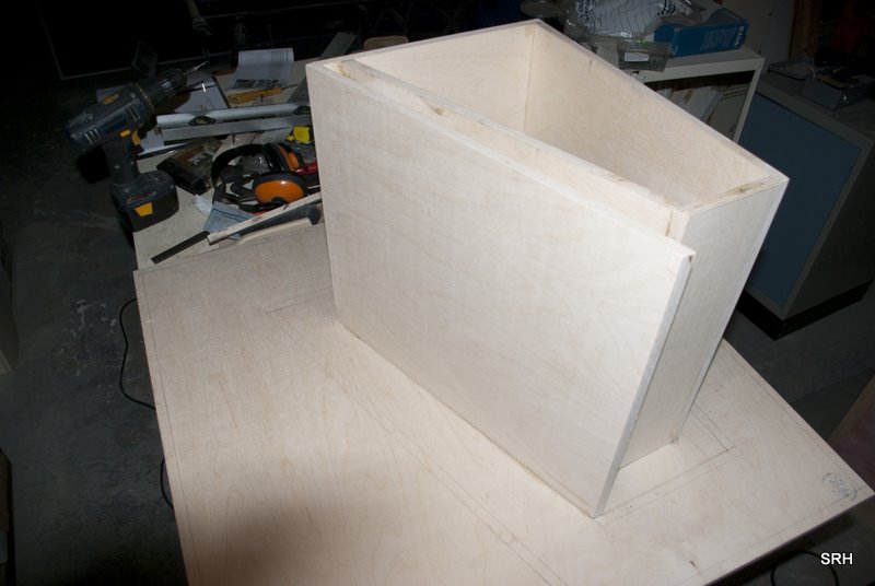

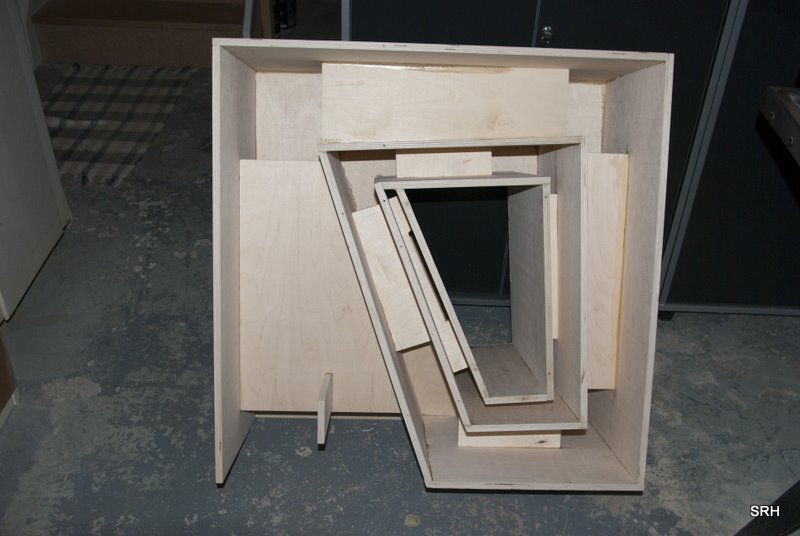

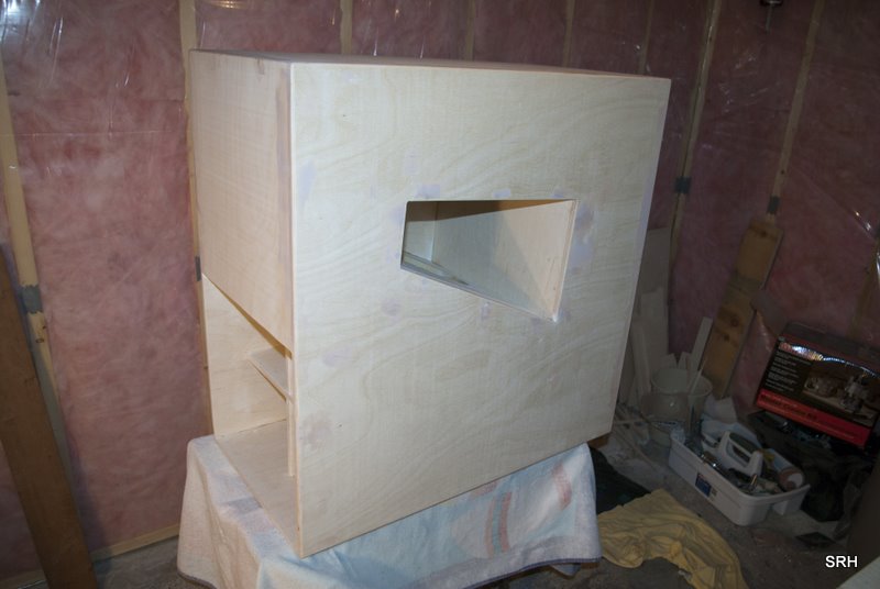

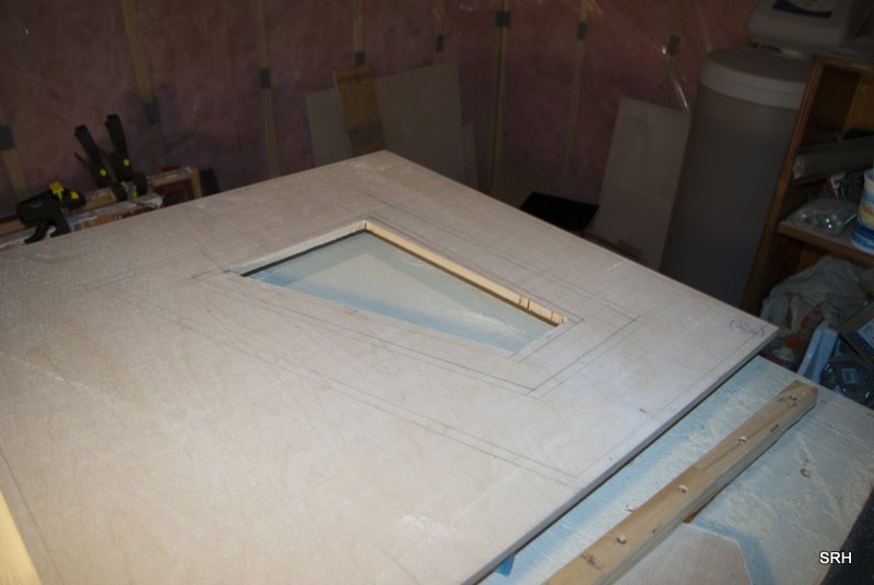

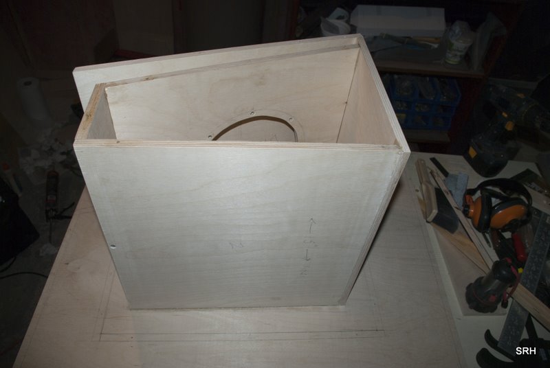

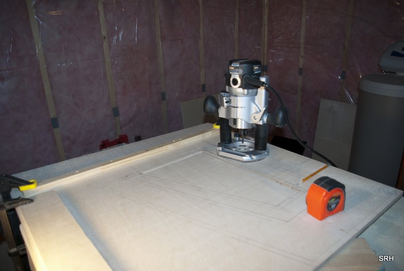

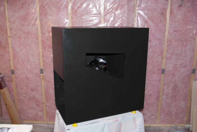

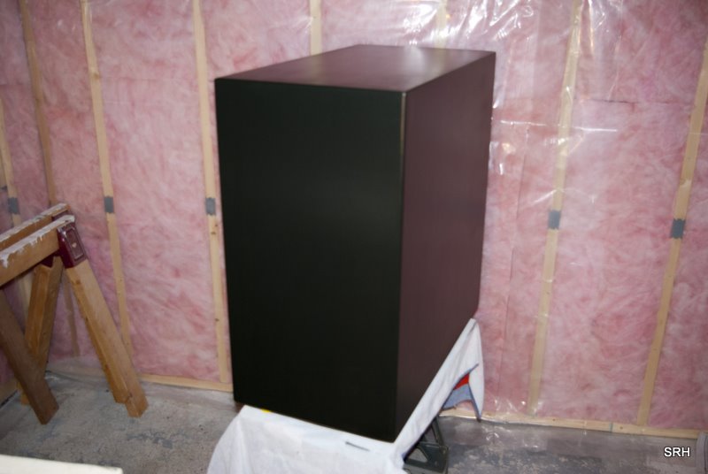

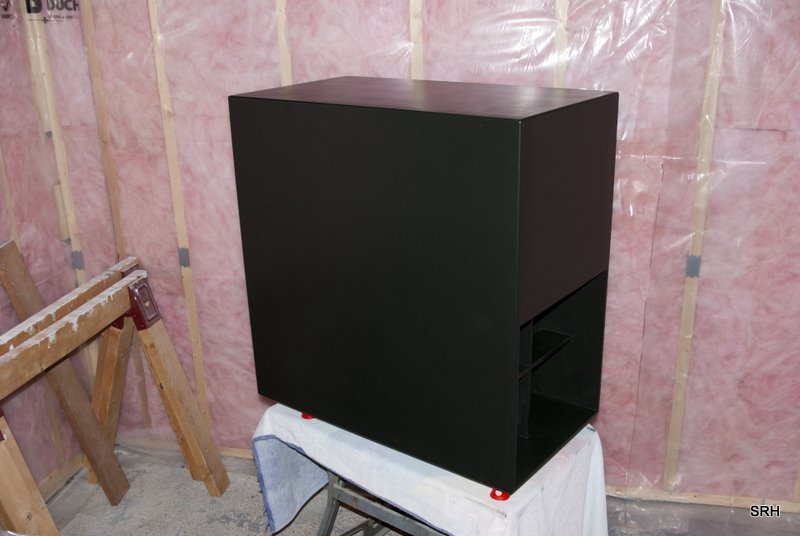

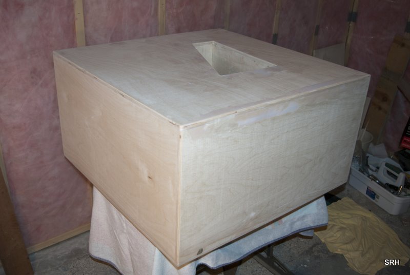

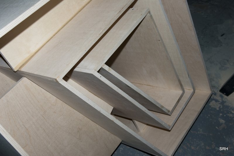

Here are some pictures from my recent 16" Table Tuba Build. Pretty much followed Bill's instructions. Cut most panels using a panel jig on my table saw as per Bill's design. The panels turned out pretty accurate and after the first few panels I started contructing without screws. I simply glued and clamped.. including the final side. Installed the 8" Dayton recommended driver. Powerred the unit with a vintage Audio Design PA100 MOSFET 100 watt per channel mono bridged power amp. Sounds great!

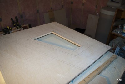

more pics

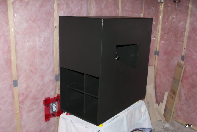

and more...

the rest...
