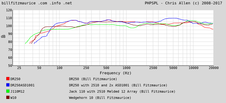

See the massive superiority in sensitivity of the DR250 from 80-300 hz? That's where the heart of your instrument's frequency response is. That equates to a lot less power needed to achieve a given spl, and much more headroom. It would take two J10s or WH10s to equal that, but they still wouldn't sound as good as a DR250. The Double Reverse (DR) design filters-out distortion, providing cleaner, more articulate sound.
Have you tried your bass through a good tube amp? If you shop / hunt diligently, you can sometimes find old Plush / Earth tube bass amps on the cheap (under $500). They're HAND-WIRED Fender Bassman clones! One of those would pair nicely with a DR250. :mrgreen:
