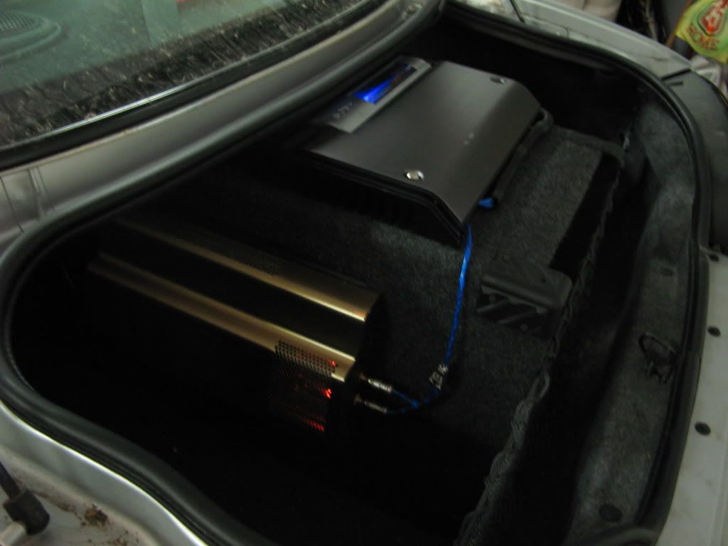

Done that with a Butler TD1500. It didn't have the punch that a solid state amp has, maybey a bad design? I'm using a sony explode (not recommended - overheats) amp now and using the tube amp for the mids.
Added some pics, I learned that around here without them it didn't happen :wink:
nice orange glowing tubes :ugeek:
