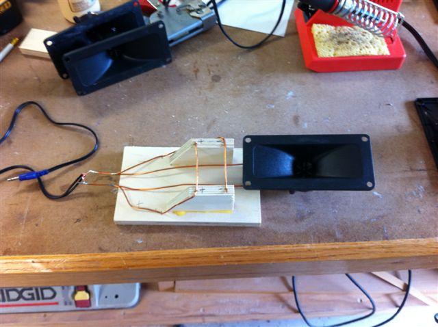

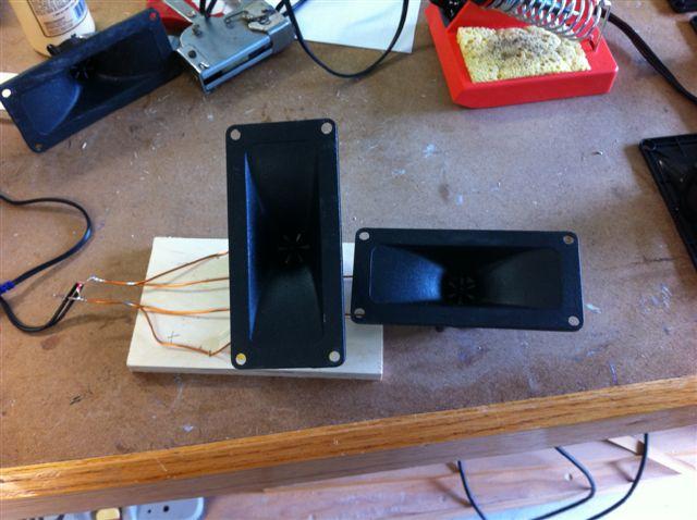

Ok, I 'm having a problem here. I build a tester. Simple design, running off the headphone output of my IPhone. The concept seems to work fine - not real loud, but works.
Here's the problem. I have one piezo hardwired as my basline. When I then add another piezo, the sound gets louder, but when I turn it around and reverse the polarity, it sound pretty much the same. I was expecting to hear a marked difference.
After testing several this way, I decided to try a 4k test tone through them. With proper polarity, volume goes down - when reversed, it's get way louder. So, my test piezo may be the one with a problem right? I swapped out when using the white noise and it made no difference.
Is it normal for there to be no discernable change when reversing polarity? Should a test tone work the same as noise when adding an extra piezo? In other words, it should get louder?
Not sure I'm doing something right here.
- Posts: 8664
Re: Questions about piezo testing.....
Here's the tester..

At 4kHz the wavelength is about 8.5cm = 3 3/8". You need to bring them really close. The long edges should be parallel and touching.
