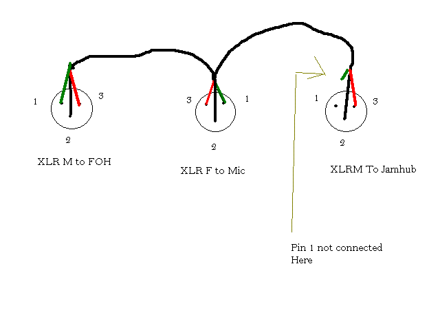

The Jamhub has mic preamps, so a XLR splitters will give you mixable levels in theory. I would probably lift pin 1 on the jamhub side to prevent ground loops and phantom power from passing through. You could also use an 8 channel transformer iso splitter.
Using the aux send method on the smaller version, you would send a submix of the instruments plus all four singers, then use your other two auxes on the board for everyone else. They also have a 7 input version if you need more individual inputs.

Eventually that would be the ticket.Greg Plouvier wrote: Are you looking to use wireless in ear?
That could work and its affordable.BrentEvans wrote: I would probably lift pin 1 on the jamhub.....Using the aux send method on the smaller version, you would send a submix of the instruments plus all four singers, then use your other two auxes on the board for everyone else. They also have a 7 input version if you need more individual inputs.
How do you go about 'lifting pin 1?
- BrentEvans
- Posts: 3041
- Location: Salisbury, NC
Re: Mixer system for in ear
Open up the XLR plug on the jamhub end and snip it.Harley wrote:Eventually that would be the ticket.Greg Plouvier wrote: Are you looking to use wireless in ear?That could work and its affordable.BrentEvans wrote: I would probably lift pin 1 on the jamhub.....Using the aux send method on the smaller version, you would send a submix of the instruments plus all four singers, then use your other two auxes on the board for everyone else. They also have a 7 input version if you need more individual inputs.
All you're doing here is using a splitter to connect this up the same way you would a monitor console. You can buy splitter snakes, splitter boxes, splitter cables, all kinds of stuff to do this. A splitter snake might not be a bad idea if you're ever going to have FOH in a normal mix position (not on stage).
