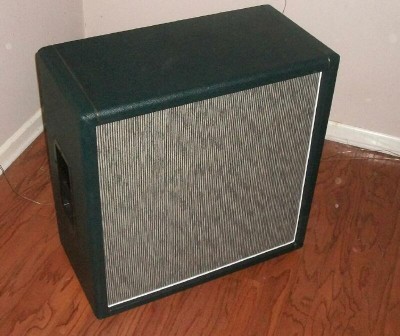

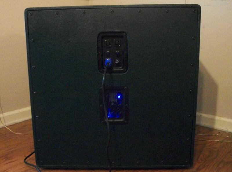

Excellent looking build Mark. What did you use for the power?
Greg Plouvier
Mark Coward
- Posts: 2601
- Joined: Mon May 15, 2006 10:47 am
- Location: Memphis, TN
Re: XF412
http://classdaudio.com/index.php/
I got the SDS 254 kit. The components weigh about 12 lbs, mostly the transformer. I found out that the transformer and PS can run two of the amp boards, so you could bridge each and have 500w RMS @8ohm per channel. The single board is 250RMS @4ohm per channel.
For typical PA duty, I'd probably go with the less expensive TI600.
