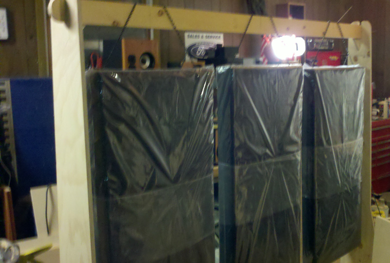

Re: Mobile Acoustic Panels
ATS Acoustics is 2 blocks from our shop. I purchased 3 2X4 3" thick black panels and built a stand to fly them back stage behind the drum riser. It made a huge difference in the scattered sound coming from the stage. It lowered our stage volume 5db as well. I would highly recommend this. I would also point your mains inward towards a focal point at the back of the roomjswingchun wrote:I just built some for our practice space in my basement. They did a nice job of subduing the highs bouncing around the concrete walls. I made them 24x48" and filled them with roxul insulation and covered them with polyester batting and fabric. I bought the roxul at a local insulation shop, but this is the same stuff for reference:
I have a few ideas for flying the panels I am making. Could you share your setup? Maybe a pic?Steve Regier wrote:ATS Acoustics is 2 blocks from our shop. I purchased 3 2X4 3" thick black panels and built a stand to fly them back stage behind the drum riser. It made a huge difference in the scattered sound coming from the stage. It lowered our stage volume 5db as well. I would highly recommend this. I would also point your mains inward towards a focal point at the back of the roomjswingchun wrote:I just built some for our practice space in my basement. They did a nice job of subduing the highs bouncing around the concrete walls. I made them 24x48" and filled them with roxul insulation and covered them with polyester batting and fabric. I bought the roxul at a local insulation shop, but this is the same stuff for reference:
Here is a pic of my flat pack stand proir to duratex. It is designed like an old wooden chalkboard stand thar was in every classroom in America way back when. I "knocks down" to four flat pieces of 3/4 Auraco. The top brace supports the flown panels. The bottom brace resides behind the lower part of the panels at a 45 degree angle to give regidity and not allow the panels to tilt rearward. The uprights are asymetric with the foot protuding more forward than to the rear allowing close placement to a wall and preventing tipping over on the performers since the load weight is forward of the upright center. I also made the chains on the panels long enough to fly them from the rear lighting truss if we are using them. The ATS 4" 2'x4' panels are light enough that they do not stress either the stand or the truss.

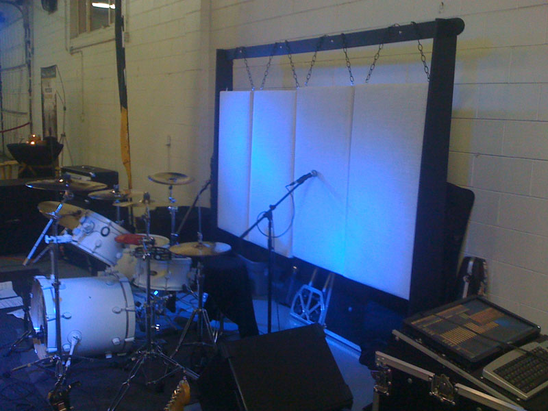

Thanks Steve, I umm....errr... borrowed your idea. Here it is at the show. It worked as expected tamed the stage reflections perfectly. No feed back and performers could hear beautifully. The rest of the room still suffered a bit from reflections but I couldn't imagine not having these in this room. I also had 8'x20' of carpet on the stage.Steve Regier wrote:Here is a pic of my flat pack stand proir to duratex. It is designed like an old wooden chalkboard stand thar was in every classroom in America way back when. I "knocks down" to four flat pieces of 3/4 Auraco. The top brace supports the flown panels. The bottom brace resides behind the lower part of the panels at a 45 degree angle to give regidity and not allow the panels to tilt rearward. The uprights are asymetric with the foot protuding more forward than to the rear allowing close placement to a wall and preventing tipping over on the performers since the load weight is forward of the upright center. I also made the chains on the panels long enough to fly them from the rear lighting truss if we are using them. The ATS 4" 2'x4' panels are light enough that they do not stress either the stand or the truss.
The panels are 4" fire retardant from ATS in ivory (thanks Brent) which really helps reflect the LED lights.
This was a trial sort of gig for the venue, it is a car restoration/custom shop that doubles the show room as an event space. Lot's of beautiful restores of classic muscle cars some old caddy's and even had some Ferraris and Porsches lying around.
The non profit that hired us had good praises about the sound.(this was there first live band event) The owners of the venue were also impressed with the sound.
Oh ya, 4 DR200's & 2 T39's vplated corner loaded covered 6,000' with room to boot.
