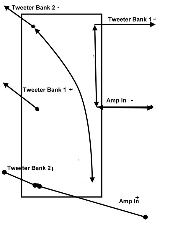

Here you go. I think. I did this a long time ago.

Ok,
After wiring it this way, tweeter 1 works in the up position, nothing works in the center, but nothing works in the bottom position either. If I am reading the diagram right, and we label the terminals as follows:
1 2
3 4
5 6
There are jumpers between 2-4 and 1-6?
Both Amp in + and Tweeter 2+ go to terminal 5?
Only the jumper goes on 6, no other leads?
I'm trying to figure this out, but it's making my brain hurt.
1 2
3 4
5 6

Re: Jack 12 DPDT switch diagram
I wish I could give the picture from David Carter but I'm having troubles in trying to do it.
Here it is, but I honestly think that the other images here are more helpful because mine doesn't show the actual terminal layout on the back of the switch. Also, keep in mind that this image was for a Omni 10 (similar to a Jack 210), and there are two switches shown--one for the piezo array and one for series/parallel wiring on the 2510's.Tom Smit wrote:I wish I could give the picture from David Carter but I'm having troubles in trying to do it.
OK so I was obsessing a little about this wiring diagram, and I actually came up with a solution very similar to Harley's, but not nearly as well drawn.
Thanks Harley! One less hurdle. I may actually get to hear these things soon!
And thanks to Tom, Leland, and David for the help. I think this thread may help some other poor unfortunate souls.
Kirk
