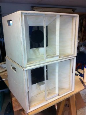

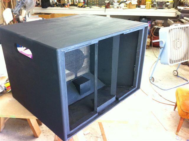

Does anyone have pictures or a description of how they mounted grills on their BFM subs?
Posts: 8674
Re: Speaker Grilles; open area?
#9 Post by Bruce Weldy »
DJ Nada wrote:Does anyone have pictures or a description of how they mounted grills on their BFM subs?
Here ya' go....
