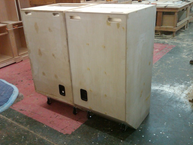

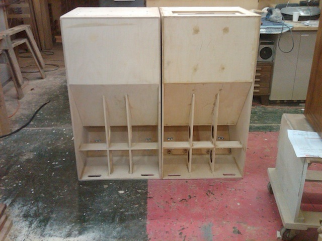

Just finish my second Titan 48 yesterday and about to load the driver in and see what's all the hullabaloo about

I load the 3015lf in the cab did a leak check and everything was okay. I then played some recorded songs for a few hours. The cabs are pretty loud but a bit boomy compare to my pair of QSC hpr181i. Maybe it'll get better over time but for now I am impress.

Nice looking build.bigtune wrote:I load the 3015lf in the cab did a leak check and everything was okay. I then played some recorded songs for a few hours. The cabs are pretty loud but a bit boomy compare to my pair of QSC hpr181i. Maybe it'll get better over time but for now I am impress.
Explain "Boomy". Is it possible that you have them low passed to high say above 100Hz. I find that mine work best with a low pass of 100Hz. Any higher and they get Hooty to my ears. Bill, does cover this in his explanation of the horn's rising response.
