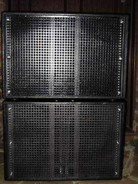

Finished my Otop 12s and used them for 2 gigs last weekend. I RTAed them in my back garden with a Dod RTA and Behringer ECM8000 and transferred the readings to my graphic EQ ready for the first gig.
We arrived at the gig early for me to have time to get the PA sounding as it should. Humped all the gear up a flight of steps, I hate this gig, and didn’t get to carry the new cabs myself, a bonus. All who saw them said how good they looked. I was feeling pretty pleased that others actually noticed.
Having set up I turned to the ‘new’ PA. I normally run 3 way but decided to run 2 way and used the internal crossovers in the Otops as this allowed me to take an amp out of the rack and make it a bit lighter. It takes 2 to lift normally. Set the crossover to 100hz and not without a little trepidation switched everything on and ran the ipod. A bit toppy to begin with but soon eqed that out. Balanced the bins to the Otops and stood back to listen. WOW!!! Was I and everyone else impressed. Great clarity, definition and spread. The bins sound pretty crap compared to the Otops though.
I had to re-eq the mics, only vocals at this gig and thought that it didn’t sound that loud. Started the sound check and the vocals were way over the top. A sign of a clean undistorted sound.
During the gig I noticed that I was hearing a lot less spill from the Otops than I have been used to, another bonus although it did make it hard to check the echo level on stage. We have no crew so all mixing done from the stage.
Being wireless, both my bass and vocals, gives me the opportunity to wander though the audience during gigs to check the sound and to make adjustments if necessary. The PA was just perfect. The 3 part harmonies blended better than before and the coverage was excellent. For the second gig the following night I didn't touch a thing and the Otops still delivered. Both gigs were crap but the Otops made everyone smile when we would have otherwise cried.
The Otops are loaded with Deltalite 2512s and Selenium DH200Es mounted on the diffraction horns. The Seleniums were used for no other reason than I already had them so they were far cheaper than buying a bunch piezos from CPC. They fitted perfectly.
I am always apprehensive trying new things purely on the recommendation of others but the Otop 12s are every bit as good as everyone says they are. They are loud, clean, clear, have great definition, are reasonably light and just sound great.

- My new Otop 12s.
- Otop 12s.jpg (142.62 KiB) Viewed 2762 times

Nice pics !!!! What did you use for speaker grills?

Thanks. I cut down some old speaker grills that I'd save ages ago. I knew they'd come in handy one day.
