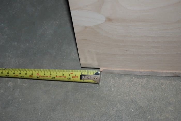

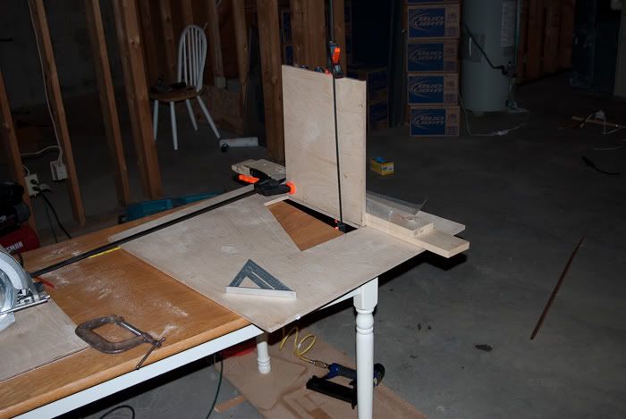

I started my Table Tuba tonight. It took me about 5 hours to get just this far. Several tool-related problems, running back to the store for supplies (after I dropped and bent my new 60 tooth saw blade... :wall:) and general trial and error.
But here she is...
The other side panel is cut as well. I can't imagine how nice it must be to have to correct tools and a big workbench (not an old rickety 4x3 kitchen table). Some of my cuts are not perfect, but anything off by more than 1/16th of an inch was put back into the pile of wood. I hope I have enough with my 2 4x8 sheets. :lol:
More to come as progress is made.

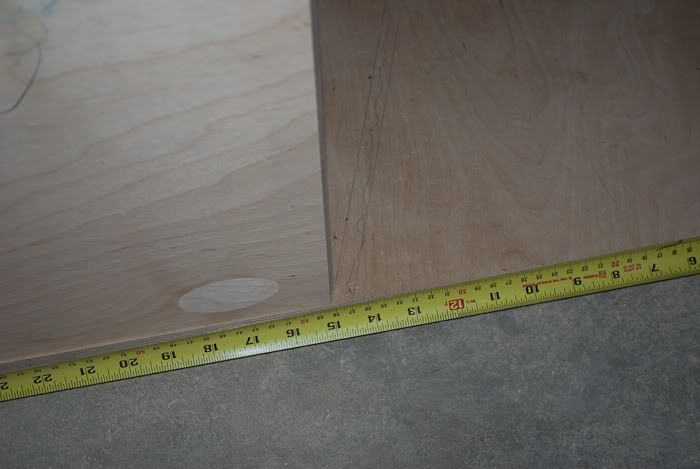

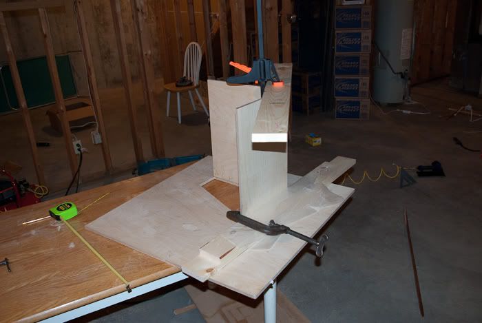

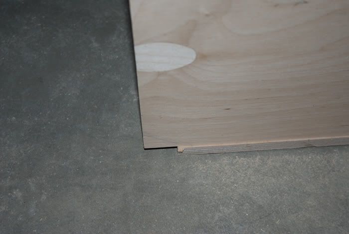

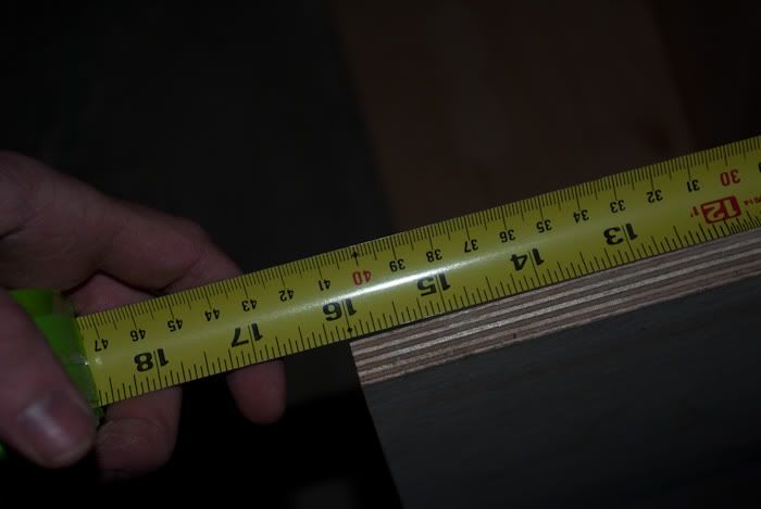

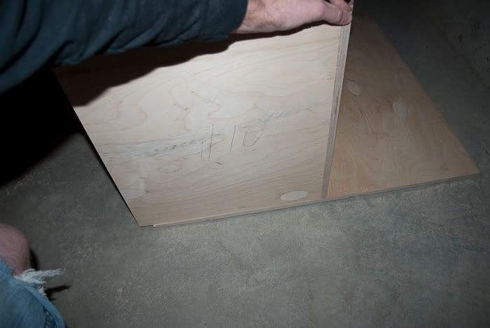

Well I've run into the first hiccup in the plan. The sub isn't here yet so I've been cutting the remainder pf the panels and fitting them to each other without fastening them in place. My problem lies with panel #10 (the front panel where the horn mouth is) and it's about 1 1/4" too long. It's cut to the exact length in the pan (16") and it is flush with panel #9 which is in the right place according to the lines drawn out in the beginning. The side panel is the correct length, 29 3/4".
To make things worse, the sketchup model says 15 7/16" for the length so that's no real help either.
I mean I can always trim 1 1/4" off to make it fit, that's no problem, but is there something I'm missing? Did I do something wrong along the way?
:confused:
Posts: 29009
Re: Table Tuba Basement Build
#6 Post by Bill Fitzmaurice »
chjade84 wrote:Well I've run into the first hiccup in the plan. The sub isn't here yet so I've been cutting the remainder pf the panels and fitting them to each other without fastening them in place. My problem lies with panel #10 (the front panel where the horn mouth is) and it's about 1 1/4" too long. It's cut to the exact length in the pan (16") and it is flush with panel #9 which is in the right place according to the lines drawn out in the beginning. The side panel is the correct length, 29 3/4".
For one thing panel 9 doesn't extend to the side edge. Consult your Sketchup model on that. And as is the case with all panels the length shown in the plans is a bit oversize to allow for trimming to the exact size required.

I see that now. ;)
Ok, that takes a little more off. As long as you don't see anything very obviously wrong I think I'll be fine.

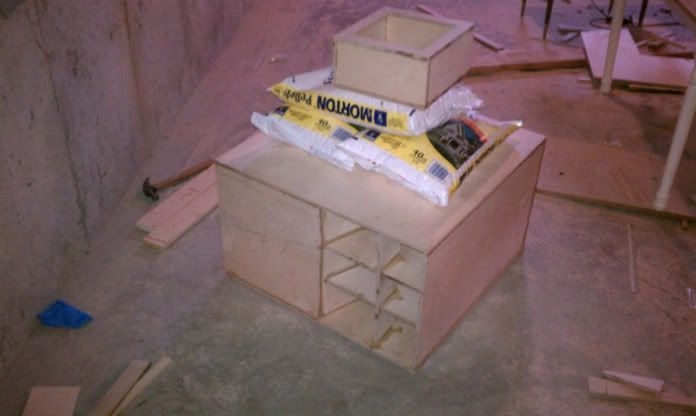

Well, it's all together! I still need to sand it down, get all the excess PL off and such, but it's all together drying right now. I didn't have any clamps that could reach to the middle and I needed to go get more salt for the water softener so... :lol:
The little box on top is for the amp.
#14 Post by DJPhatman »
Congratulations! :clap:
Get yourself a sharp 1/2-3/4" hand chisel to remove the excess PL. Works like a hot knife through butter. Give the PL a few extra days to cure, extra heat helps. I used a hair dryer pointed into the mouth, with a blanket draped over the whole set-up.
