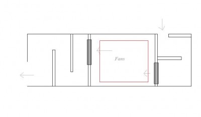

I found a couple hushbox designs and thought I'd try my hand at one. Please critique my design. I'd rather build once and have it be right.
Here's a front shot of the enclosure:
Here it is in X-ray vision so you can see the baffles and air channels:
And here's a top shot:
The intake for the projector is under the lens and the exhaust is on the left side towards the back (in the picture of the projector at the link above, you can see the exhaust vents). The fans on the enclosure are 3 120mm computer fans run at 1/2 speed. I want to line the hushbox with damping material that will further absorb noise from it and keep it inside the box. The window at the front will have glass (anti-reflective) installed.
What do y'all think? Sorry it's off topic. When I get my BFM HT built, I won't be able to hear the projector anyway, hushbox or not (or the microwave, or the vacuum, or a tornado, or the cops knocking....)! :loler:

In general, for cooling you are better off with fans blowing air INTO a case, rather than sucking air OUT of a case.
I would keep much the same design, but move the three "exhaust" fans to the right side (looking from the front) of the case, and direct them to blow air into the case. These could be near the back of the box where you have the rectangular air inlet. I would also cover the fans with some kind of lined grill to cut down on the amount of dust that gets sucked into the projector.
Using a little foam gasket tape, you can "seal" the intake side of the projector from the exhaust side. That will go a long way toward keeping the air moving in the right pattern.

Mkay, fans moved to the intake side. This actually allowed me to move the angled baffle on the exhaust side over more away from the projector for more space:
More opinions welcome!

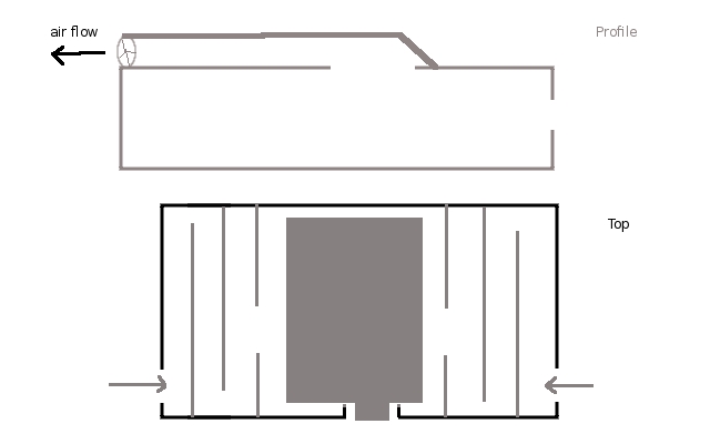

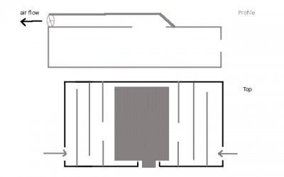

You know, it's funny you mention that. The design I posted at the top of this thread is actually the 4th redesign. Here are the first 3:
1:
2:
3:
Unfortunately, I'm limited by external size of the box. This thing will have to hang from the ceiling above the couch in the livingroom. The WAF is already not looking forward to a bigger thing hanging there than the projector/shelf already is. My previous 3 designs have pretty tight channels and don't really leave room for damping material. I can probably go larger vertically, but not depth or width (shoot, the design is already 28" wide). Tryin to find the best compromise, you know?
But, if you see a way that I didn't to organize the channels, maybe with a little bit higher ceiling in the enclosure, please, let me know! I'm definitely no engineer. :noob:
Thank you for sharing your thoughts and knowledge, DanielNY! :) I really appreciate everyone's help on this.

I think it's a toss up between design 1&3. In every design you have the fans all on one side which may be asking too much of them and wont bring in enough cool air. If you have two pulling in cool air from one side(preferably as parallel to the bulb as possible), and another 2 for exhaust would work better. Also, the channels dont have to be the same thickness as the outter shell, all you need is 1/4 material with a thick cloth like speaker cabinet covering to line the channels.
Just my two cents...
Hmm...definitely food for thought. So instead of simpler wider channels and thicker damping material (V4), you're recommending longer more complicated channels with bends and folds and very thin damping material right (like V1, 2, and 3)?
I can pick up a 4th fan, no problem. I just hope that 2 fans bringing in the air will be enough. Might have to run them at a higher speed. This projector really does pump serious air through it. It has 5 fans inside it! O_O I'm not kidding. It's no wonder it's as loud as a microwave.
Question: if the interior of the box is sealed, would it make a difference whether or not there are fans at both the intake and exhaust? I'm askin because I really don't know. Physics wasn't my strongest subject. ;)
Gonna have to go back and explore the first and third designs.
Thank you, sir!

Well, here is the best I can do. 4 fans (two intake, two exhaust), all 4 buried inside the enclosure, all 4 fans behind baffles, enough room for sufficient airflow, and top venting (this was the hardest part):
Top view with top piece removed:
Side view (exhaust side) with side piece removed:
I heightened the box by 2.5 inches (total inner height is now 9.5") to allow enough room to stack the fans. Wish I could go wider, but 28" OD is as big as I can get. I also reduced the inner walls to 1/4" pieces instead of the previous 1/2" pieces.
What do y'all think? I think this is the best one yet and a real candidate for the actual build.
