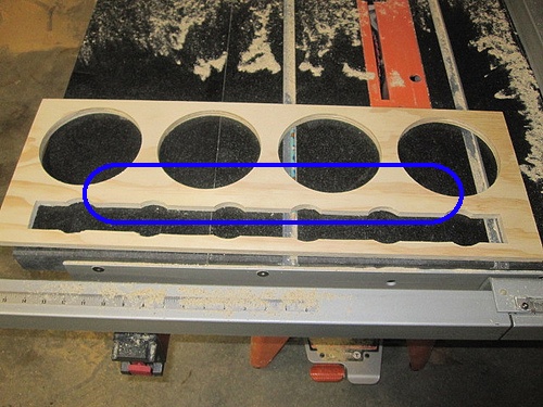

Ripped all 8 panels from Arauco. Was going to do the baffle in BB, but I'm out of panels long enough... and I'm too impatient to wait until tomorrow night to start ;)
Laid out the centers for the drivers. Used a hole saw for the tweets.
Setup for the woofers. Using a Craftsman circle cutter, same setup as the holes for the T39 mouth braces.
However, this was taking way too long on my POS drill press, so the plan is to use some 1/4" Luan I have laying around for a template, and cut the first hole on it. Then I'll use the router to make me a nice 1/2" template. I'll then use double sided masking tape and a flush cut bit to make the driver holes.

Baffle all cut.
Side port/handle setup with double-sided masking tape. Holds pretty well as long as you don't handle the router like an ape.

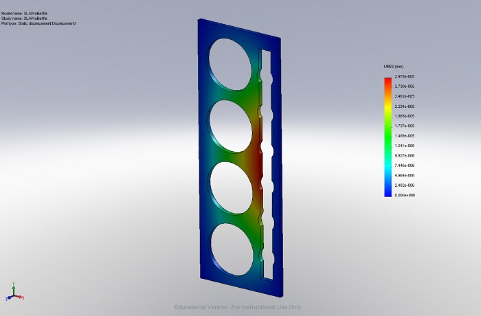

I don't have plans in possession, yet.
Is there any bracing to connect the baffle to the rear of the cab that would run the length in between the driver and piezo cutouts? That baffle looks like Swiss Emmentaler, and although the metal driver baskets would partially recover some of the structure, I seriously doubt the ABS piezo housings will be doing anything to handle stresses along that whole edge.

Radian wrote:I don't have plans in possession, yet.
No. When the drivers are screwed and caulked in place the baffle is stiff enough without a brace, though you could add one if you wish. A stiffener or two connecting the baffle to the main brace would suffice, and would be a good idea if you go with 3/8" BB for the cab.

I might drop a single one in between the drivers. The Arauco feels like balsa wood, it's so light.

Bill Fitzmaurice wrote:No. When the drivers are screwed and caulked in place the baffle is stiff enough without a brace, though you could add one if you wish. A stiffener or two connecting the baffle to the main brace would suffice, and would be a good idea if you go with 3/8" BB for the cab.
Just for a visual of what I was talking about. The displacement values are bogus because I ran the plot using steel (wood isn't available in my sim) and the dimensions were completely eye-balled, but the distribution of the resultant displacement still comes through nicely. Red is the area of greatest deflection along the Z axis using a pressure applied across the entire face of the baffle.
