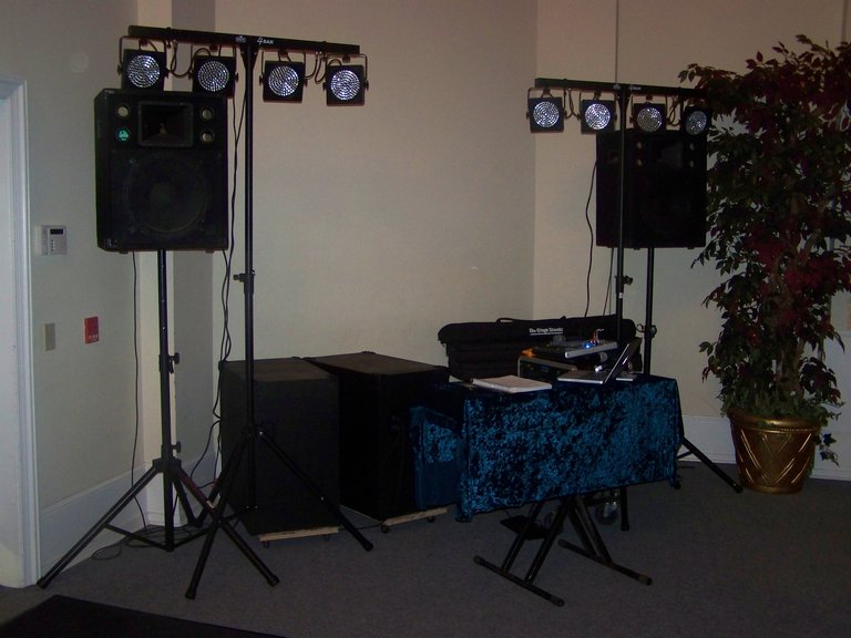

Indoor job #2 (DJ gig...last night I was playing live) with the Tubas and this is where I'm set up this evening. The tops are probably about 8-10 feet apart and the Tubas are right behind me pointing into the wall. I've got headroom to burn...haven't gone past 12 volts on a sound check that was speakable over, but loud enough to dance to. Sound is covering the room really, really good. There's a door and a hallway on either side of me, and the "dance floor" is immediately in front of me, so this seems to be it. Love it so far, punchy and powerful, but people can converse easily, feels totally effortless. No noticeable nulls on a walk around, even in the adjacent rooms.

You need some BFM tops up there Donny!

Ditto man! That should be starting this week.netwerks wrote:You need some BFM tops up there Donny!

This was the weirdest job...sounded great, but man were they wall flowers. They when they did dance it was fine, but once they were done, they were done...hmmmm.......got compliments though. Guess they were just ready to go.Radian wrote:Nice setup Don! Glad to hear it went well.
