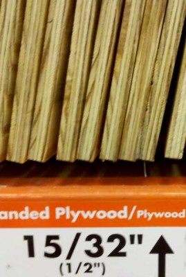

Hi guys,
I'm joining the darkside, and gearing up build a THT. As I walk through Home Depot this evening (for some unrelated household supplies) and I decided to strode by the lumber section to see any thing new with usable Birch plywood, unfortunately it's the typical crappy Birch. Anyways I did noticed that they have another type of plywood called Sanded Plywood, the 1/2" type has 4 even layers. Are these any good for building a THT box, since they are pretty inexpensive?
Thanks,
Dan
Thanks,
Dan
Re: Sanded Plywood 4-layers?
The recommendation is 5 even ply. I wouldn't use it.
It's crap. Do not use anything from HD.

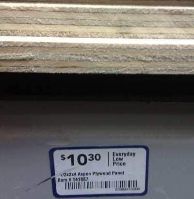

Since the Woodcraft store closes too early, so I went by my local Lowe's this evening to check out their plywood; the only one that are 5 even layers i see are "Aspen Plywood", it doesn't have the thin veneer layers... one of their staff said it's actually Luan plywood. The only size they have in stock are the 24"x48" sheet. Are these Luan plywood anygood?
BoostFab wrote:Since the Woodcraft store closes too early, so I went by my local Lowe's this evening to check out their plywood; the only one that are 5 even layers i see are "Aspen Plywood", it doesn't have the thin veneer layers... one of their staff said it's actually Luan plywood. The only size they have in stock are the 24"x48" sheet. Are these Luan plywood anygood?
http://billfitzmaurice.info/forum/viewt ... t=luan+ply
I'm glad the Lowe's employee said it's Luan, I'm going to stay away far from that.
