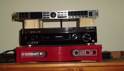

With a little creativity, I've been running my HT subwoofer in direct defiance of the AES using pro-level gear in the form of a modified K2 amp fed from a DCX2496. The items were not being used at the time for their intended purpose as PA equipment, so instead of spending money for the correct gear to accomplish this, I relegated them to duty in my HT. It worked, but wasn't what I would call convenient . Talk about lighting a cigarette with a cruise missile.
The 38 pound modified K2 idles at 200W when there's no signal present making it a more effective space heater than the TV. The PEQ on the DCX had to be setup or adjusted adhoc using a test CD and SPL meter. On top of that, there's the classic HT start-up sequence that runs like a pilot's take-off checklist: 1. Source-check 2. Receiver-check 3. Crossover-check .....sit down to watch movie, cue opening scenes...GF chimes in before I can even open my drink, "Where's the bass?", @#%#$ "Oops, thanks sweetie." 4. Amplifier - check

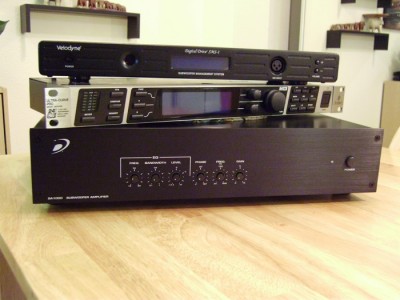

Recycling funds by liquidating a pair of surplus speakers has allowed me to finally purchase some consumer level gear that's a little more at home in the home. DCX gets replaced by the SMS-1, and the K2 gets replaced by a Dayton SA-1000. Everything is now sharing the same interconnects, the same color, less heat, RTA for tinkering, and finally it's all on a 12V trigger.

So what's in a Dayton SA-1000? Parts Express has good pictures of the fancy exterior, but here's some big photos of what makes it tick.

Got everything wired up.
Not so hot right out of the gate. When running the sweep signal out of the SMS-1...nothing came out of the sub. I had to turn my receiver way up...then I'd finally hear some bass; too much because now everything was cranked. I'd turn the volume down only to hear a whole bunch of garbled crap coming out of the sub that went away after 3 seconds or so, then no output again. :conf: WTF?
So I removed the SMS-1 from the chain and tried just the SA-1000 by itself. Sounds great! It is however much more sensitive to ground loops than I had anticipated. Anytime the Blu-Ray player is fired up, I get hum from the sub. It's coming through the HDMI cable and making its way to the sub amp. The amp itself is not inherently noisy. In fact, it's output is dead silent. It's just very susceptible to signal chain issues. When I hook up my walkman CD player directly to the amp...it plays cleanly, no hum or distortion. I'd be inclined to use toslink between the BD player and the receiver, but then I'd loose out on the max bit rate audio available through the HDMI cable. We'll see. I'll pick up a line-level isolation transformer. Blocking the loop at the amp input, I believe it'll cure the issue as that seems to be the only source. The cable box is not the problem (unplugging all of those connectors didn't change a thing), everything is plugged into the same circuit with polarized plugs (can't flip them around), and lifting the safety ground on the amp was only good for a ~2 dB spl drop (verified by meter) in actual the noise from the sub at max gain. Signal path from the receiver to the SMS-1 to the SA-1000 is less than two feet.
The SMS-1, on the other hand, has issues that require further investigation. :| I'll be taking it to the lab for testing before I give Velodyne a call. This was a brand new sealed unit, so it shouldn't be doing any thing like it's doing. It appears to have an input threshold issue. Once the input gets to a certain level, then the output kicks on. While the output is on, it's heavily distorted. Kill the input, the distorted output continues for bit, then all stop again. We'll see. Picture's worth a thousand words. I'll get it on a O-scope and see what's up. Worst case, it'll have to get it sent back to Velodyne for repair. :fingers:
So for now the SA-1000 is running solo and doing a fine job. I'll let you all know what comes about as things progress. In contrast, the DCX / K2 combo had none of these issues.
