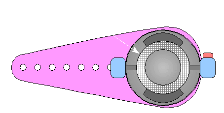

I made one like the first photo shows. I used a scrap piece of paneling. I only made the necessary pivot holes once the router was ready to make the cut. I also used a scrap piece of plywood as a 'backer' for my work, (pivot hole is also drilled in it, so bolt passes right through it). I didn't attempt to cut the entire thickness all at once. I made a few trips around, each time raising up the router plate a bit. Holes were perfect. Made me feel like a pro.

jswingchun wrote:Measure from the outside of the router bit to the pivot pin and double it.
For the outer cut (first cut) you should measure to the inside of the bit.

chrapladm wrote:And how do you know what size hole you are about to cut with this jig
What I found to be the simplest and most fool proof way (important points when I'm near a router) is to draw the actual circle with a compass and then screw the jig to the center point, and then slide the router on the jig until the bit aligns with the circle. This way there's no need to measure the router.

I planned on using my angle bit that has a 45 degree angle on it(like a round over with out the curve). I read in the plans to angle the cut for the driver placement and thought it would be easiest to use this bit.
I wlike the idea of the first picture but it was just a matter of me maiking a template that actuall lines up with the base of my router. The WB idea seamed easiest to build. I have a straight edge guide that came with the router so I would just use the guide rails. Drill some holes for the rails and attach all to the pivot base.
