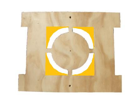

How would it affect the sound if the outside of the cutout in the new Jack baffles was round instead of square?
Posts: 29056
Re: Four Jack Stack
DaveK wrote:Bill,
Quite badly, as you couldn't make an airtight seal between the horn panels and baffle. Square pegs into round holes will not go.

I know if I was making a Jack again I would make some sort of pattern to cut out those holes in the baffle and do it with a router. I hate cutting with a jig saw, even with a guide board. I don't have the newest OT12 plans, is the baffle similar to the Jack baffle? I will probably be building more OT12's next year.
I do have to say that as far as construction itself goes, I really like the phase plug baffle. I thought it was A LOT easier to build then the old style like the Omni 10 I replaced.

Bill Fitzmaurice wrote:
DaveK wrote:Bill,
What I was thiking was a circle of the same diameter as the throat opening. It would look something like this (thanks for the pic, Leland.)
