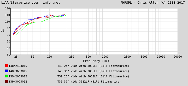

Here's a chart. (also keep in mind that you still have to eq them somewhat flat and that 50-60hz range is where the "beef" is at)
And last but not least, about using your subs for stands (ESPECIALLY folded horn subs), yeah, what Bill said.

Wow, the line for the 30" T39 rides right between the T48s which I didn't realize previously. Are those graphs averages of a few builds or world records? Regardless, I'm definitely set on T39s now, 39x30x19.5. Since 2*19.5 will fit the width of the van easily, I can go for max cab width (filling the van's height).

Actually those graphs from Bill's prototypes. In pro sound, we don't "average" the results like other fields might. A measurement is simply taken from a finished product. Of course, these results should remain constant and are easily replicated since the drivers are usually pretty much identical and, if done correctly, the cab will also be identical.
These graphs are basically what you get from big name manufactures in the "spec sheets". They simply measure a speaker to make sure it has the they want and then, just compare everything else that is produced to guarantee that you get what it is advertised. But I'm pretty sure that the lower priced from cheaper manufactures, they just get massed produced without a final test.

Ok cool. Just to go back to the graph for a second... why is the 30" T39 so much better in this graph than on http://www.billfitzmaurice.com/T39.html? They seem to refer to the exact same cab, but
Former: 100 @ 43 Hz and 105 @ 65 Hz
Latter: 100 @ 65 Hz and 105 @ 85 Hz (maybe a pre-3012LF driver? I've gathered that that is a new development - how new?)

3012 came out sometime in 2009. I'm not sure why that graph is different, but the 30" inch titan is noooo joke.

Yeah, I believe that the one on the front page is the delta12lf. While most of the graphs on the spl tag tool are loaded with the newer drivers: mostly kappalites. And I think where it just says " 10 inch driver" it is referring to the s2010.

Cool... that older graph was a main reason for my original hesitance in dropping from 48 to 39. The extra 5dB in the "beef" thanks to the kappalite is very reassuring. Hopefully Bill has a moment to update the chart for others in my situation.

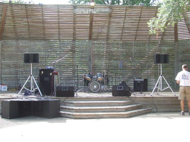

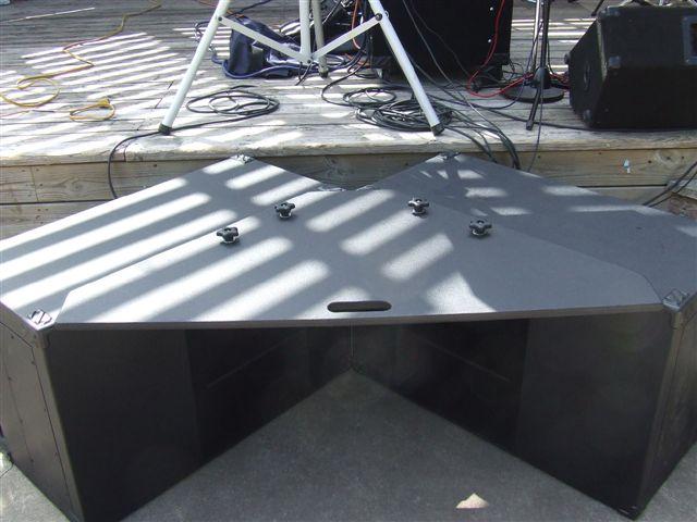

yeahforbes wrote:Can someone link to a a few posts that include pictures of Titans used for live sound? I saw the DJ setup that made the wedding cake lean over, and corner loading in a situation like that is really easy for me to grasp because DJs very often set up against a wall. But I'm still a little lost regarding practical ways to boundary load on a live stage since the tops are so rarely near a wall. I know it's difficult to localize a point source for LF, but isn't it still fairly disconcerting to hear the LF and HF come from very different places? Must the tops be delayed?
I have my tops delayed 7 feet (I believe that is the correct amount for T39s). I don't have any pics of boundary loading inside, but we've been playing a pavilion with two sides open and I just put 'em up against the wall next to the stage and have ample coverage all over the place and way more volume than we need.
Here's some pics of and outside venue with the T-39s V-plated...
