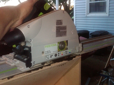

:hyper: I was at a family gathering talking to my father about my BF cabinet projects and telling him about my desire to get a better table saw. My father, known to his friends as "Milt the Toolman", looked down his glasses at me and said "No, you need a Festool plunge saw". OK, Dad, whatever. He left a catalog at my office and I gave it a look. After all, he has been getting smarter as I have been getting older. Hmmmm TS-55 Plunge cut saw...well I do some plunge cuts in the plans...I'll go check this out.
http://www.festoolusa.com/products/plun ... 61174.html
I went to a local tool store to look at one. I left with it! Here's the deal. For the price of another average home owner model table saw ($480.00) I got a TS-55 saw and guide sled. Yes this saw runs on a sled just like in the plans! The Germans took it a step better. This sled has a guide rail that keeps the saw locked in so it can not drift either direction while cutting. Just like in the plans once you make the first cut the on the guide the sled is set to your saw and all you need to do is line the "cut" edge on the guide of the sled with your cut marks and presto you're ready to cut! put the saw on the sled. Press the unlock button and the pull the power trigger. The saw blade starts to rotate and the unit pivots downward plunging the saw into the matterial or start the saw at the edge of the wood and cut straight accross. Perfect plunge cuts for access covers and perfect milwork quality cuts for all the other panels. Yes, the saw pivots for angle cuts. Again the Germans, knowing you will the building horn loaded cabinets, made the saw pivot on the cut line to eliminate blade drift. No more recalcuating cuts and compensating for the change in the blade offset. Just set the sled guide edge on your cut lines at the long side of the angle, start the saw, pluge the blade, cut, and presto! Ewetho and I just did 2 Otop 15's today and, Damn! My table saw is history!
:twisted: All I have to say now is "Bring on the DR's...and thanks, Dad."
Here I am cutting the horn plates on an OTop15 with my new Festool TS-55 ... SWEET!

baronvonsteve wrote: Ewetho and I just did 2 Otop 15's today and, Damn! My table saw is history!
:twisted: Muwa-ha ha
definitely "Vorsprung durch Technik"
