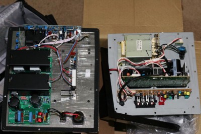

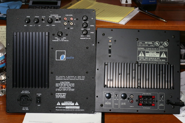

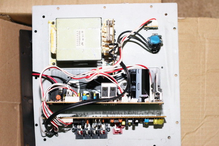

here are some pics of the Bash 500w and the Foster Plate amp that NHT used
The Foster is heavy at 9.5 lbs. compared to the O Audio 500 at about 4
If any of the smart guys out there are interested in the parts inside one of these just ask and I will snap a close up of the area you want to see (gotta make it clear though what parts you are talking about?)

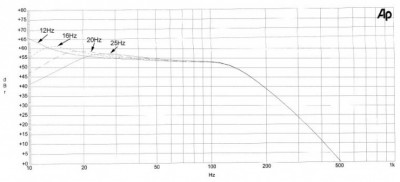

P.S. I'm not encouraged by the rapid rolloff of the BASH above 100Hz.
Syd[/quote]
I will most likely be crossing over @ 80hz and limiting the mains to 100hz as this is what Bill does to tame the rising response of the THT or in his case the TT.
Even if I took the sub up to 100hz how would this roll off above 120 hz or so affect the sub?
Built; T18, 2 x J110 2510II MA
Sydney
Re: Behringer A500 vs Bash 500
#11 Post by Sydney »
Depending on how aggressive the slope rates are of both components of your crossover, it may make integration difficult.
As a common practice: having linear response for a least an octave above and below crossover point, makes integration more predicable.
On p97 of Sound systems: design and optimization By Bob McCarthy is described "Spectral Acoustic Crossover Summation".
Basically non symmetry in the crossover region causes shifts towards the stronger component.
If the BASH started it roll-off above 200Hz the summation would be clear-cut; as is @ 160Hz it is already approx 6db down.
Syd

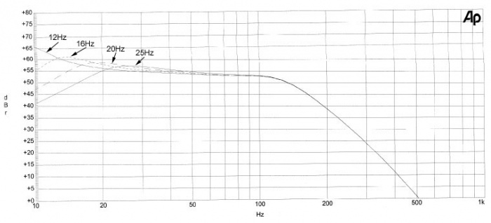

Went to the Oaudio site and looked at the chart again, noticed that chart is with the 120hz xover in, at this link http://www.oaudio.com/docs/manual_v1_6.pdf. Is the owners manual with 2 charts at the end that shows response with no xover in place as well as 40 and 120
Sydney
#13 Post by Sydney »
Ah Ha... Got me on that one.
Common sense should have warned me that graph reflected the action of a 120Hz filter ( approx 24db/octave ). The manual clarified.
Syd
