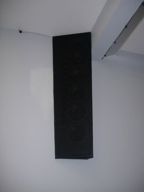

Got them mounted and hooked up.
Awesome! :!:
Very even coverage by ear and by SPL meter, need to run tone through them and check again.
Not as feedback resistant as I had hoped. Unfortunately our piano is under one speaker and sometimes people will stand by the piano and under the speaker and sing. Not bad if they hold the mic right but if they are more then a foot away from the mic it seems as if it will feed back as you push up the gain to compensate for the bad mic technique.
You can bring the highs down a little and it does help.
They look awesome, nice and sleek, way better than the old speakers hanging off of the wall.
If you want a good installed speaker consider these. I am very happy.
I was the one who found this site and suggested we build these, Now that they are great I am relieved.
My neck was kinda on the line, so to speak.

As far as the mount -
After using sketchup and looking at the angles I realized that the sound would hit the front row between at about 5 feet off the ground. 1/2 way between sitting in the chair and standing. Also realized they would just hit the front of the stage. So figured no big deal and went real 'High Tech'.
A piece of plywood inside at the top glued and screwed, then a 1/2" piece of ply screwed to the back with 1" above to top of the cabinet. Predrilled holes so easy to put screws through it and into the wall. 2 guys held them up and I screwed using a long reach driver to get over the top of the cabinet. I used to install cupboards that are heavier when loaded with dishes and such, with just 4 screws. So i figure 3 in the plywood plate into the wall would be plenty.
Using an SPL meter (and by ear) the sound on the platform behind the field of coverage is almost the same as in the coverage. So tweaking for perfect coverage to me is not a big deal.

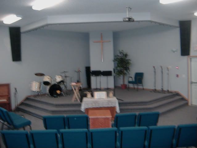

Used them today for the first time.
Overall very good comments. Many liked the sound, A couple said they sounded 'Hollow" or "tinnie" Maybe I need to break them in more? Just put on music and let it play all week days with no one here? That is what a guy who was here who is a DJ said. (Son of a regular attender, who was visiting.)
As far as looks, they are real nice, sleek units. We choose black as we are repainting the church in earth-tones and thought white would not look good. They 'frame' the platform well.
Sorry this is blurred

I had to shorten them to 56" and went with 6 of the Eminence Alpha 8 drivers.
The price was real close to 8 of the 6" drivers and the 8" will give me better bass.
"The cab will work down to around 60 Hz or so, meaning that in many applications you’ll be able to get by without a sub."
Actually when you crank them you can feel the bass. Not a punch in the chest but not bad.
I also cut and glued the piezo's for a " multi element single mouth tweeter horn". which according to the plans
"Eliminating the frames between the piezo tweeters gives better integration of their wave fronts for flatter response."

Cjeff wrote: Many liked the sound, A couple said they sounded 'Hollow" or "tinnie" Maybe I need to break them in more?
Are they pointed directly-at-the-listeners in the vertical plane? A laser pointer taped along the edge of a combination or try square, then swept from side to side will give you a visual idea of the spread those arrays. They could've been off-axis and out of the zone.
:confused:
Posts: 29093
Re: Thanks Bill and everyone - TLAH Pro !!!!!!!!!!!!!!!!!!!!
Cjeff wrote:Used them today for the first time.
Have they been RTA/EQ'd for the room? If so what some may call 'tinny' is highs that they never heard before.
