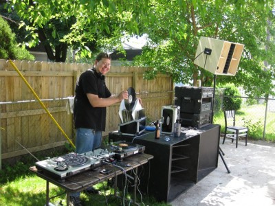

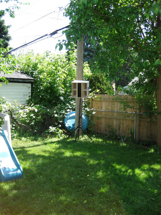

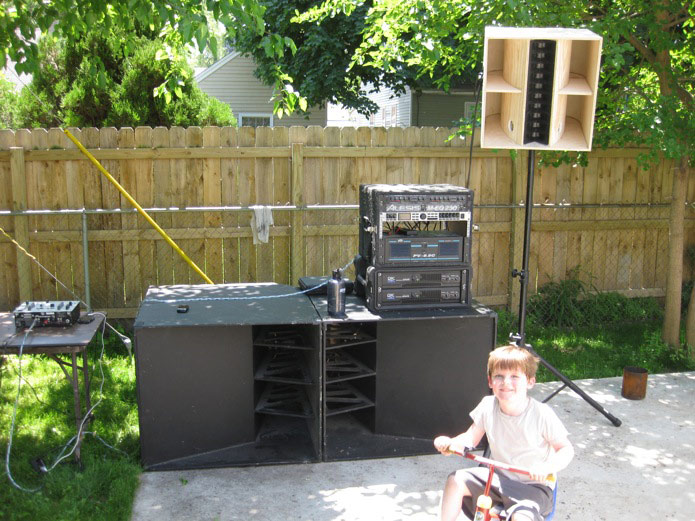

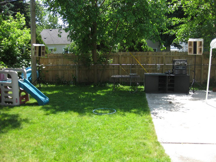

Pictures:
4 DR250s
4 Tuba36s @ 30" wide
2 ATs
4 DR250s
2 ATs
