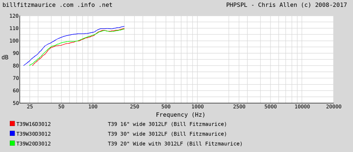

Looking at the chart, there doesn't seem to be a huge advantage of going with 20+ over 18 (keeping in mind my "sweet spot" of 60-80Hz for hip hop)... unless I'm going all out to 30 inches. If I take a single, I don't know that I want to lug around the heavier unit, though, so that's why I'm considering 24 inches for the single.
But, how badly am I neglecting the benefit of the two cabs @ 18 inches?

6 dB at 50Hz is an awful lot of 50Hz that you are missing out of!

Chris_Allen wrote:6 dB at 50Hz is an awful lot of 50Hz that you are missing out of!
Indeed, but my back is happier ;)
TBH, I cross over right at 50Hz. Does the response flatten out simply by adding the second cab? With two 18 inchers, aren't we talking an additional 4-6 inches of mouth?

But back on topic... what effect does doubling up on the T39 3012 @ 18" have versus a single @ 30" (not considering V-plating)?
Are you talking about a comparison about two 18" wide cabs and one 30" wide cab? If so there's not a lot of difference, the 18" wide cabs can go a db louder on average, they have more versatility and they can be V-plated. That's about it.

Due to your original graph looking weird (read: sucking :P ) I decided to repost.
But if you cannot go with your original plan, simply default to the plans: build as wide as possible. So if you want the slim pair, then go for it and then just build the wider ones to take up the extra space. And for small gigs, i would rather take the two slims than one of the wider ones. I mean, it doesn't really matter that you gain 2 extra db from going wider if you can't fit all four of them in your truck.
So in a nutshell, Pros for 2x18s:
- About half the weight for each carry
- Can be v-plated or stacked depending on situation
Cons:
- Costs an extra driver with no additional output over the single 30"
- Additional build
You're not making this easier!! :mrgreen:
