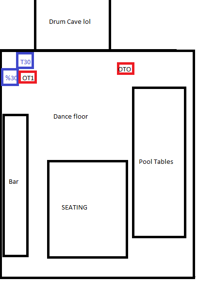

Re: T30/Otop 12: Live band setting
hahaha, the whole point of a review is to stimulate the very discussions we are having right now!
The drums were on a drum platform, unfortunatly they were also placed in a terrible location hahahaha. The way it worked is there was a like... cave like thing... maybe 15 feet wide, 25feet deep, with 9 foot ceilings. The drums were raised up maybe 2-3 feet. Floor was directly in front of that, and I corner loaded the tubas off to the left of them.
Ideally I had more room in mind not a...
Syd
I have had problems with these sort of cavities as they can be a reflective resonant nightmare.cave like thing... maybe 15 feet wide, 25feet deep, with 9 foot ceilings. The drums were raised up maybe 2-3 feet.
Syd
yeah, it wasnt my ideal place to set up drums either... I had to go back there to adjust mics a couple times and I swear the snare was going to make me go deaf. i sent a buddy home to my house to grab my musicians ear plugs for the drummer, cause I was genuinely concerned about his hearing.
Unfortunately the venue manager was deadset on setting them up in the little cave, cause thats where the platform was, and thats where these guys have put drum the other 4 times they have played here.
