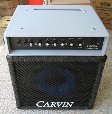

I just did this to a little bass amp:
http://carvinmuseum.com/decade/92-bassamps.html
I duplicated the original amp mount, i.e., screws from the top. The box is left over 1/2" Arauco with butt joints, PL glue, brads. There is a long heat sink in the back of the amp so I cut out top and bottom vent holes for better passive cooling that was in the original amp. The speaker is a new Eminence CA2010 Basslite...a mistake in my case. I have no intention of keeping this particular box but I happen to have a "spare" CA2010 until I sell it.
There's a thread on DIY cases and may give ideas. If cushioning is important, there are ways to build a box within a box, maybe with foam or springs as shock mounts.
