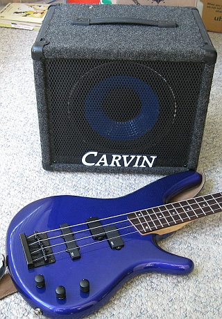

I may be mistaken, but small bass cabs are prone to mid-bass hump, and the slew of small boxes are demand-driven products with big tradeoffs. I wish I could remember where Bill commented on that (IIRC). It only confirmed what I knew had to be the problem, and why I ended up building J110's. I carried around this Carvin amp, the PB150, for years as a cute practice/backup amp:
http://carvinmuseum.com/decade/92-bassamps.html
I played a couple gigs with it and the volume was there, but tone was not (nobody could tell except me). This particular design (around a 10" driver) has some awful ~200-ish hump/resonance that could not be removed no matter what I did, even replacing it with a neo speaker (I'm more ejimukaytd now). Trying to record from it was was not good either. That's what convinced me, at least, to avoid small boxes. I still have that box (minus airhead) and it just does not sound right next to a J110. Makes for a good stool, though.
Try some out but bring a J110 with you for a baseline.

#9 Post by loupey »
Had the camera out and thought I'd show the leftovers of my combo amp. That's an Eminence CA2010 Basslite. Actually sounds better for guitar than bass with that mid-bass hump (the box's fault, not the speaker)!
