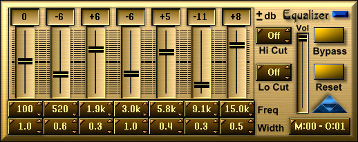

A few weeks ago I had the opportunity to take the pair of DR200s forum member Brew has out to a family gathering. I used SAC to run the gig, and this also gave me the ability to RTA and measure them. The response curves very closely mirrored the published charts, and I didn't think to get screen grabs while I was doing them. I did, however, get a grab of the EQ curve I used, which had them pretty flat from 120 up to 16k.
The sound was very nice and smooth, got a lot of positive comments from family, some of whom are reasonably familiar with good sound. In any case, lots of interest in the rig all the way around.
For those of you not familiar with the SAC EQ, it is parametric. The number at the top represents the increase or decrease in gain in dB, the middle number is the frequency, the bottom number is the bandwidth in octaves. For example, the 3.0k filter is -6db at 3.0k, and rolls off half an octave above and below that.

I also see the aggressive removal at around 8K-10K (can't remember the exact spot).
I've seen that applied to about every piezo implementation I've come across.

Chris_Allen wrote:I also see the aggressive removal at around 8K-10K (can't remember the exact spot).
You can overdo it there, depending on the mic location. In larger rooms, or outdoors, high frequencies are attenuated at longer distances and/or smeared by room interactions, so an RTA taken at relatively close range might cause too much EQ cut at longer range. Always take a listen throughout the listening area, and if your ears say you need more highs let them override the RTA. OTOH aggressive boosting above 12kHz is seldom of value, as there's not much up there to hear, assuming you can hear it anyway.

Bill Fitzmaurice wrote:You can overdo it there, depending on the mic location. In larger rooms, or outdoors, high frequencies are attenuated at longer distances and/or smeared by room interactions, so an RTA taken at relatively close range might cause too much EQ cut at longer range.]
I did the RTA outside (since that was where they were going to be used), with the mic at about 15 feet. Granted there was a bit of wind, but the results were very satisfying aurally.
I walked it 180 degrees around the speaker, out to about 75 feet distance. It was very even. The 15k half octave boost made a noticeable difference in sound quality. The SAC EQ is very very clean and does not excessively interact between bands like a typical 31-band or even some parametrics, so my results may not
transfer to other EQs unmodified.

BrentEvans wrote:A few weeks ago I had the opportunity to take the pair of DR200s forum member Brew has out to a family gathering. I used SAC to run the gig, and this also gave me the ability to RTA and measure them. The response curves very closely mirrored the published charts, and I didn't think to get screen grabs while I was doing them. I did, however, get a grab of the EQ curve I used, which had them pretty flat from 120 up to 16k.
I tried this EQ curve last night and was very pleased with the sound at the gig, really good departure point when starting out. I have never RTA'd my system and rely only on my ears for tuning. Thanks for the post.
