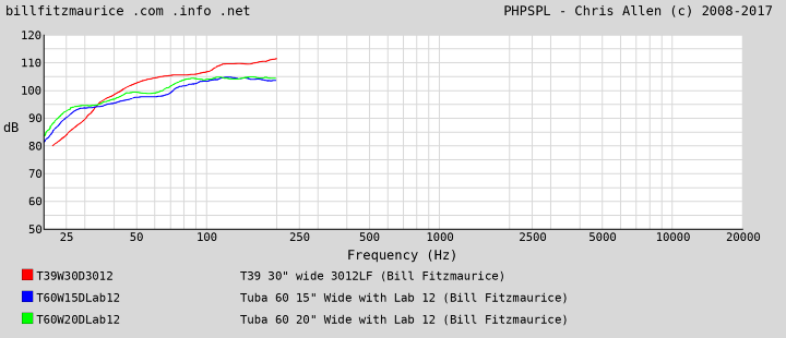

Emm after doing some more reading I think I could build two tuba 60 slims and they would fit the layout of my trailer. From what I can see those will out perform the Triton with little problem.
Re: T39 size
Its your back... not mine. The T60 will go lower than the T39
The 20 inch wide T60 will have similar pack space to the 30 inch T39. It will be 21 inches longer though, which is enough space to fit another 30 inch wide T39.

First, know your extension needs, after that you can pick the cab. That's why there's different disigns, they have different advantages and compromises.
Re: T39 size
5 string bass goes down to 30hz... T39 has pretty *decent* output at 30 (crossover will pretty much eat that though). T48 has a lot better. As far as I can telly, you have little to no need for the t60... Unless you run a pipe organ in your band.

The fundamental is down there, but the fundamental output is miniscule below 45Hz. If it were not so the Ampeg fridge withe a 58Hz F3 wouldn't be able to handle the low B. Even the T39 is quite adequate for 5 stringers, as are the O15s, O12s and Jack 12s.sine143 wrote:5 string bass goes down to 30hz... .
As for subs for live sound, for anything less than pro-touring I'd go T39. What the T48 delivers garage/bar bands don't really need. IMO even pro-touring doesn't actually need what T60 is capable of, we offer it because there's a demand, if not a need.

The t39 might not *hit* 30 hz... but then again, most bass cabs used by bassists wont really *hit* 30 hz again. I still think he would be a lot happier with the t39/top combo than with a dual 15 or other bass cab.
