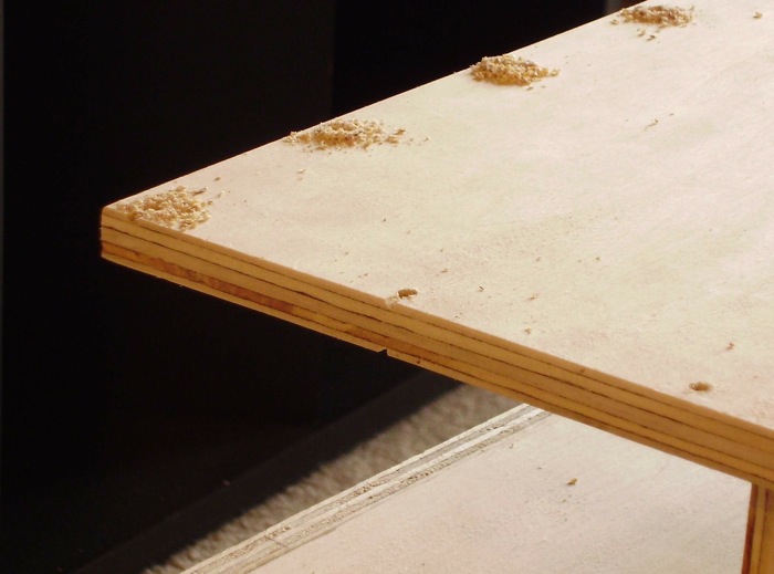

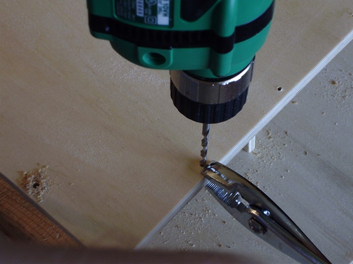

Here's a quick and dirty way to prevent plywood from chipping when drilling holes close the end grain (Shown in the bottom picture :chainsaw:).
If you don't have two pieces of scrap wood to sandwich your material between while drilling, this can get you by without much more sweat. It's a matter of lightly pinching the wood with pliers near the hole until the bit cuts through.

Drill a pilot hole as small as you can, hit the backside of the hole with a countersink bit, then drill from the top.
Also, I've heard of using bit fat fender washers to clamp in place with the vise grips. Again, a pilot hole is useful here to make sure you don't drill into the fender washer.
