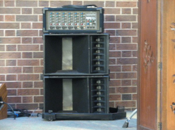

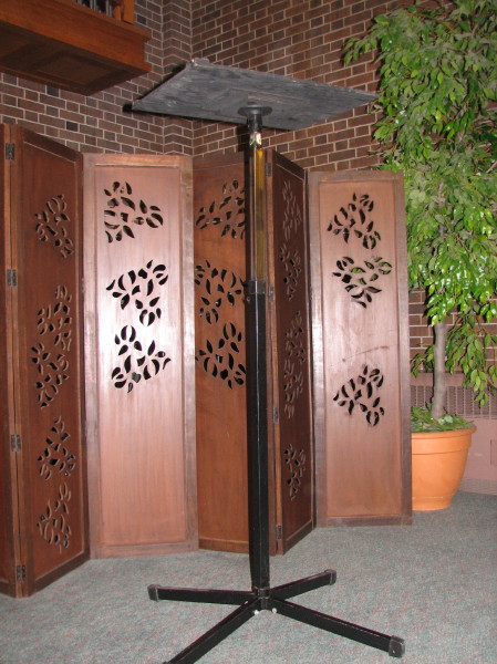

Sorry for the pic quality. A pair of Omni 10.5s (S2010) on a refabbed cart so that it can roll behind the screens when not in use.

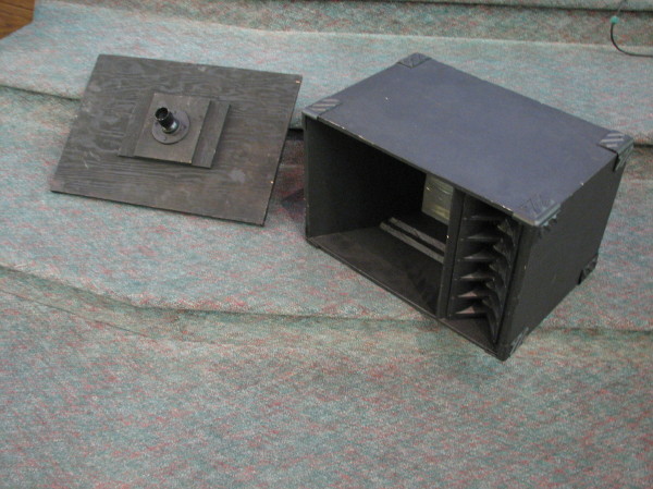

Home-made platform for O10.5. 1 3/4" x 3" (?) pipe nipple into a pipe flange. Always used with a load strap.
Platform on speaker stand

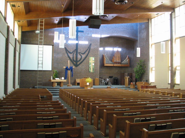

The room where the rig normally resides (just under the front organ choir pipes)

Yesterday I was in the sanctuary trying the cabs as single or double on the stand. Also, tried them(full-range) with an AT (through a 20?mh inductor) which I felt really anchored the bottom end nicely. I plugged the cabs into the monitor amp, which I had plugged into the FOH with the all other cabs disconnected. The mixer has "high", "low", and sweep-able mids from 300 to 4k hz. What I found during my 2 hour trial is that I had to cut between 6-9 db at 400hz to get a sound that I liked. Why is that? If it was not cut, it sounded too much like "hollow"? which bothers me. I dunno. :( Any ideas? Thanks.
Posts: 28975
Re: Omni 10.5 thoughts and pics
#2 Post by Bill Fitzmaurice »
tammojsmit wrote:What I found during my 2 hour trial is that I had to cut between 6-9 db at 400hz to get a sound that I liked. .
That's where the cab has high sensitivity, and the room acoustics might also accentuate that region.

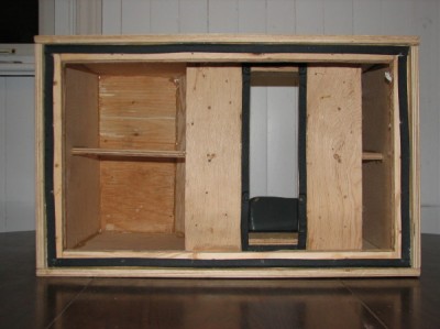

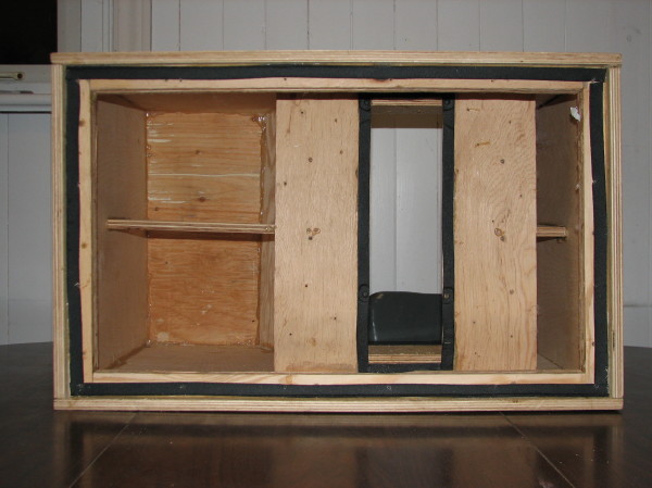

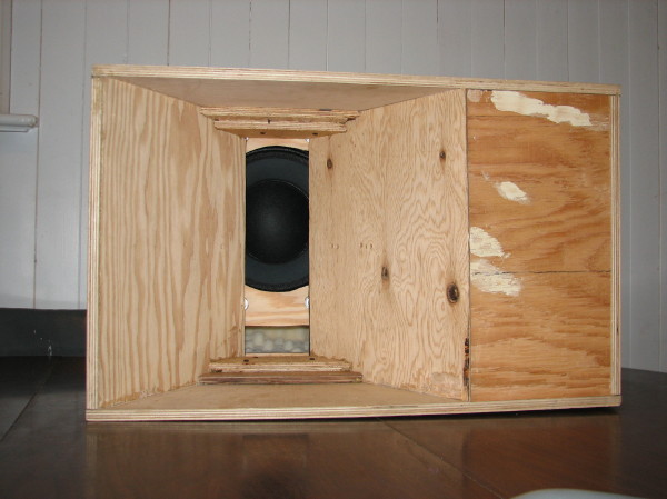

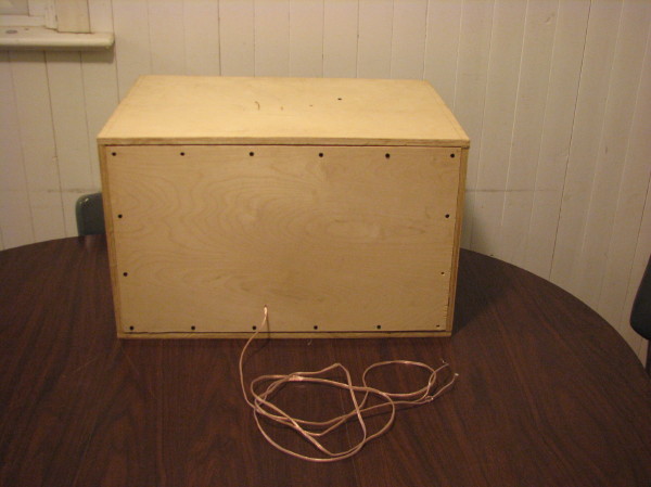

I thought I'd add a couple more pics. These are of the first cab before I had any tweeter arrays built and therefore only used it as a bass cab. (it's the table that's warped, not the cab bottom)
This on shows the hot glue which is all that held in the blocking panel. When the tweeter array was ready, I just cut the hot glue, added the flanges and arrays.

Yes, understood. And they are/were, such that all surfaces, except for the baffle, are covered. 8) The empty cab was just to show the temporary panel that was just held in with hot glue.
