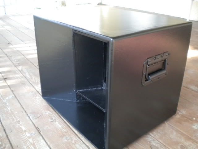

let me start by listing the pre-conceived ideas i had before this build:
1. a DIY cab was going to be hard, and probably not turn out very good.
2. a single 12" could never compete with my 4x10
3. not using the piezos would make the cab sound "vintage" (read: muffled)
the cab build went surprisingly fast, i had the box done in 3 days, only working on it for an hour or two at a time. unfortunately the beta12 that i bought on ebay got damaged in shipping, alas the box sat empty.
not long ago i finally had some cash and ordered the "right" speaker from leland, along with handles/hardware.
i didnt want to spend more than i needed to at the moment, so i passed on the piezos and crossover and grille for now.
first impression: WOW! :hyper: :hyper: :hyper: i A/Bed the new cab with my old peavey 4x10 (rear ported with tweeter), and the 4x10 doesnt stand a chance. when given the same amount of power, the jack112 is definitely louder, lower and clearer. also i really expected the jack (no tweets) to sound muffled next to the 4x10(with tweeter).... not the case. the old 4x10 sounds like it has a thick blanket over it. my girlfriend (who couldnt give a rat's ass less about speakers) was surprised at the difference.
unfortunately my camera battery died after one pic, so ill have to post more pics ASAP. now if you'll excuse me, i need to go put my old cab on craigslist.... thanks Bill!!!

FYI: high resolution pics make sloppy glue jobs painfully apparent. next time i will be using ALOT less PL. also note that this cab will be getting duratex and a grille in the near future. it doesn't look perfect, but it sounds great!

Your glue job ain't half bad! If you are really worried about it you can clean up the corners where the glue bulged/squeezed out with a nice sharp chisel. I picked up a three size variety pack at Harbor Freight for $4 a while back just for that purpose. Just go under each end a little and it should pull up in one big piece. Then when you Duratex it, it'll look fantastic.
most of the sloppy glue job is in the throat, so i think once the grill is on i should be good. i got alot out with a chisel, but its hard to work in that throat (too tight for my hands). thanks for the kind words!
