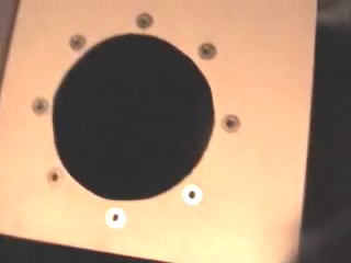

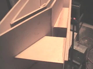

Heres the pics of the AT build:

for some reason i am having major trouble trying to post the rest of the pics,i will try again later.

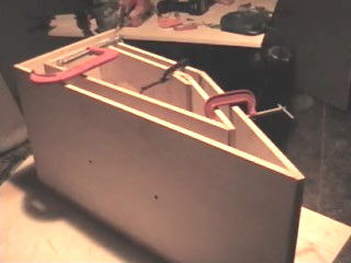

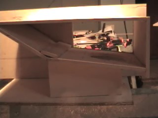

trying again,more pics:

next panel:

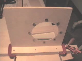

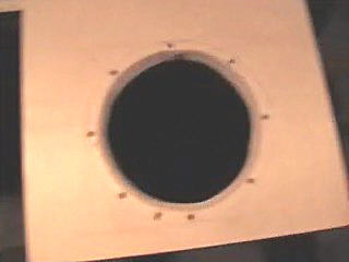

next panel:

next panel:

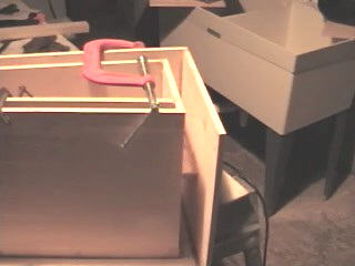

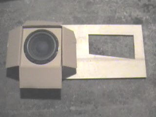

next panel:

next panel if it goes right:

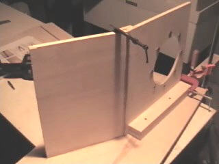

next panel:

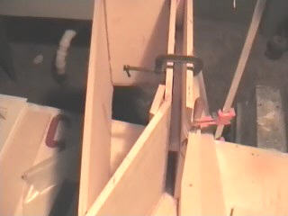

I dont know whats going on but whenever i try to post a pic,the site takes me back to the log in page although i was already logged in.Im gonna try a few more times.
