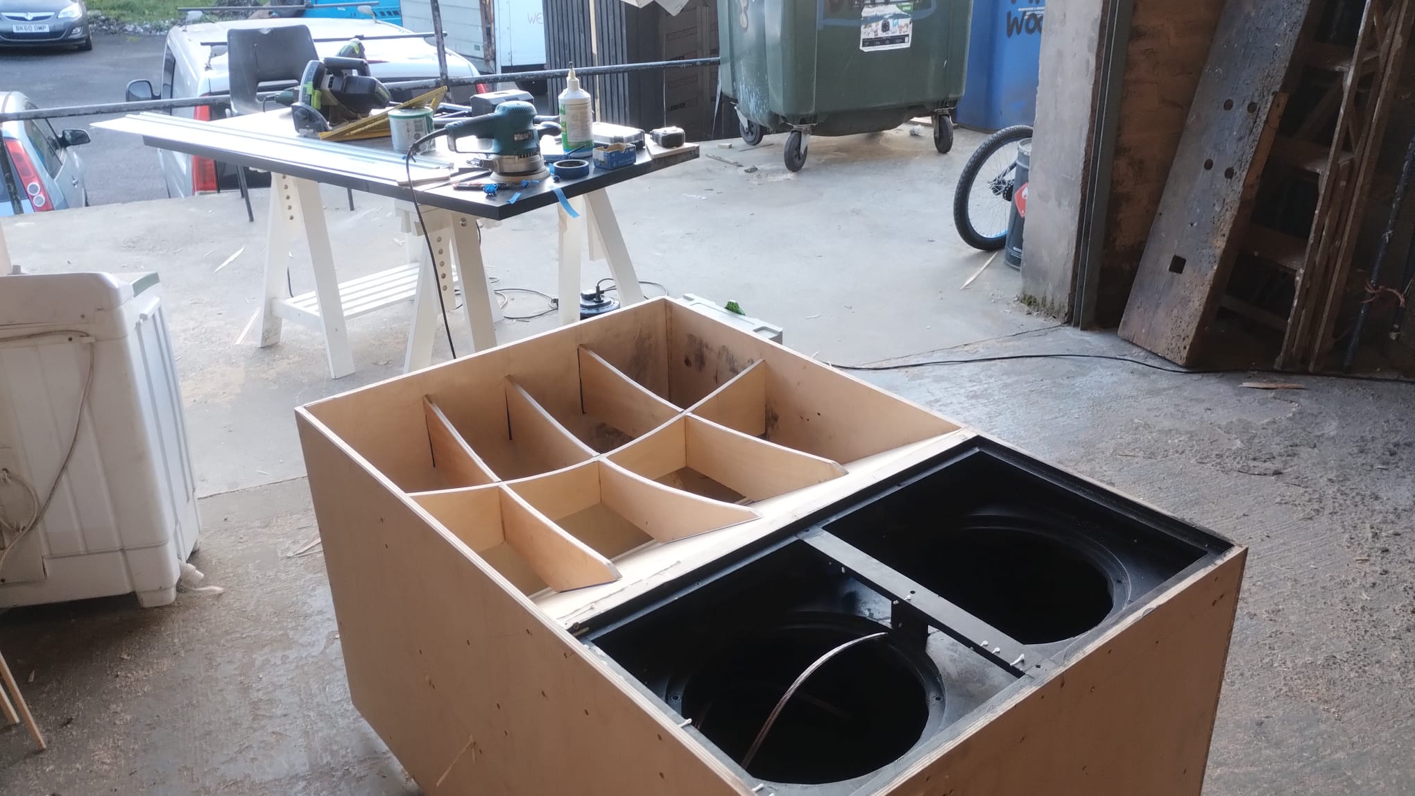

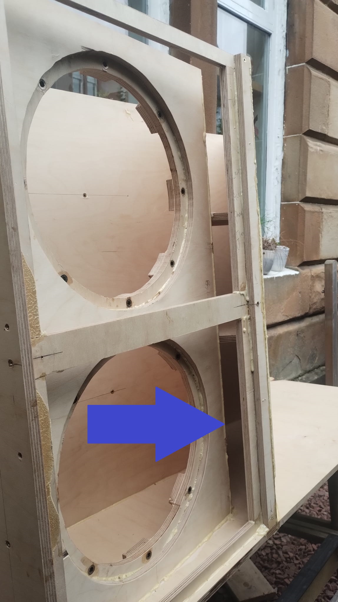

A closer look at some of the pics and I agree with Chris...
With a 30" cab width, using only 2 braces perfectly spaced puts them slightly further apart than the maximum recommended distance between braces. They don't need to be perfectly spaced, in fact Bill has said that having them unevenly spaced can help reduce unwanted resonances. But, you want them no further than 9" from the nearest brace or cab side. Too far apart and it allows the panels to flex slightly which reduces output and negatively affects overall response of the cab.
In the picture below, it looks like there's about 12" without a brace where the arrow is indicating. That area of the horn is subjected to greater pressure swings that cause vibrations than the more voluminous portions of the horn path and it's pretty important to have it braced well. Definitely add some bracing there. If you can't sneak a full length brace in from behind, cut the brace into two or more pieces so you can get them in and around the existing brace that may be blocking the way. Slide one piece in, then the other/s. Not an issue if they're not perfectly aligned, spaced, or matched up. If there's more than 9" between the other brace and the other side, add one in there too. Just want to eliminate any possible panel flex there and 4 braces in that spot wouldn't be a bad thing at all. And use at least 3 braces per panel throughout the rest of your build. But don't sweat it if you only used two between panels 3 and 5. Using 3 braces between panels 5 and 8 will sufficiently support panel 5, two on one side, 3 on the other. If you're running low on scrap to make braces, you can use any quality of ply for the braces, doesn't have to be the same as the rest of the cab. The cheapest, ugliest ply you can find is fine for braces. You can even make the braces out of ¼" / 6mm ply.

I will add in that third brace in that 12 " gap between panel 4 and 6 , glad u spotted it !
Those pics were before i put in any braces around the baffle and its framing. I've now got exactly the 4 braces specified in the plans (two flange to baffle - one more or less under each driver cut out. the one between the central vertical and the baffle and the larger baffle to panel three Brace. ive ofset them a bit after reading what your saying about resonances Seth. and i'll add one more little flange to baffle brace too, so its less then 9" unbraced in the centre of the horizontal lower flange .

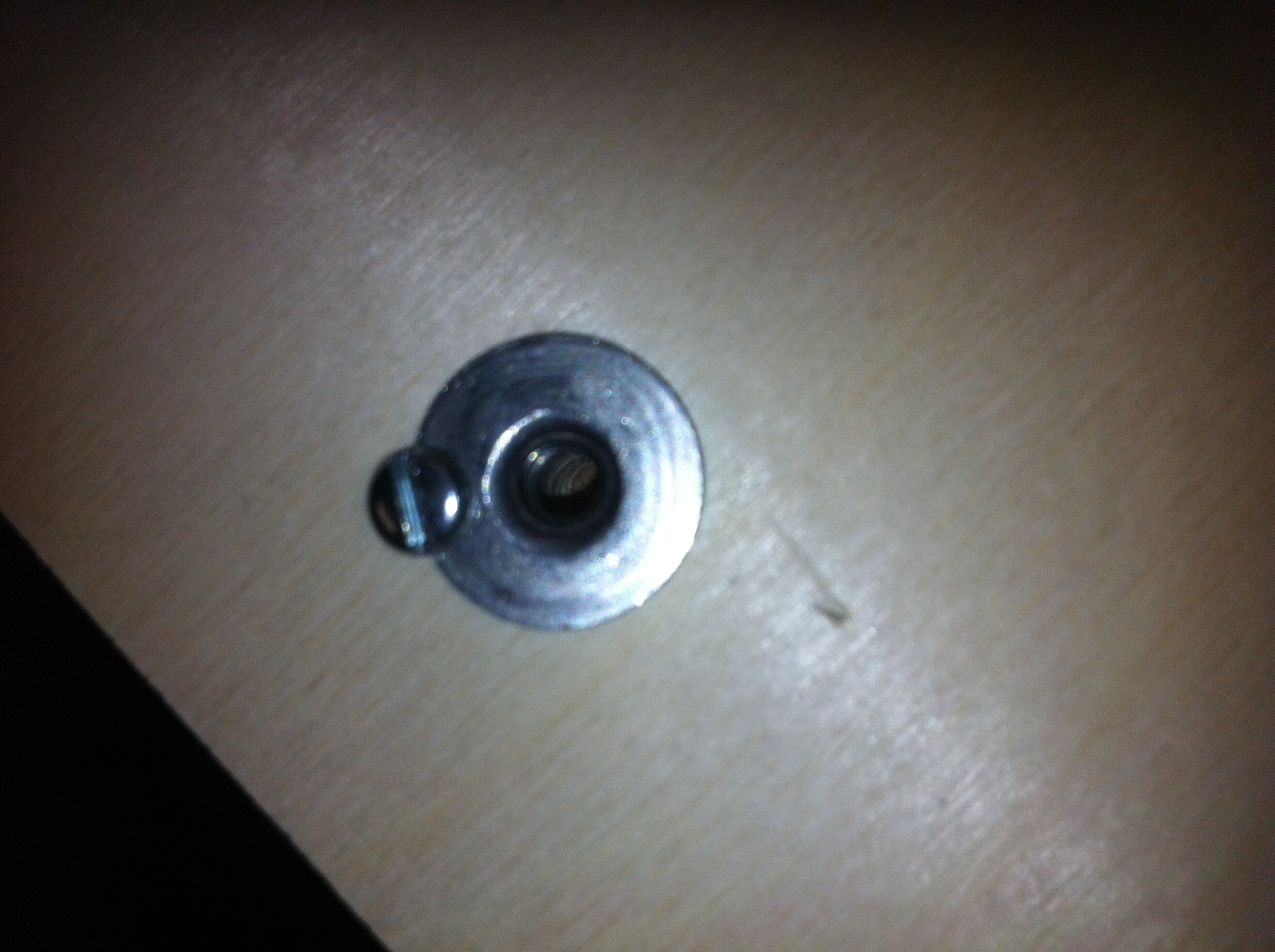

When you say insert nut, I'm assuming that you don't mean a T-nut, but rather one that you see in furniture? Threaded on the outside to for gripping the wood? If so, that is NOT what you want to use. That will most likely spin with the bolt when you try to take it out. Then you're screwed....pun intended.
If you don't use a wood screw, then use T-nuts and lock them in with a screw on the base of each one to keep 'em from turning. Epoxy alone isn't enough.

I use T-nuts and epoxy/screw secure them as pictured. I also typically use Loctite 243, as i'm in no hurry to open the cabs back up for screw tightening. I've changed drivers on one of my Titans without any issue. I also used those pound in jagged threaded inserts in my THT access cover with loctite 243. Took that apart several times for amp upgrades and a driver upgrade without issue. BUT those were #8 screws. You start getting #10 or more and like Seth mentioned, there may be enough torque to pull out threaded or pounded inserts. So T-nuts/epoxy and a screw FTW. I like the epoxy to keep the screw in place/tight too.
