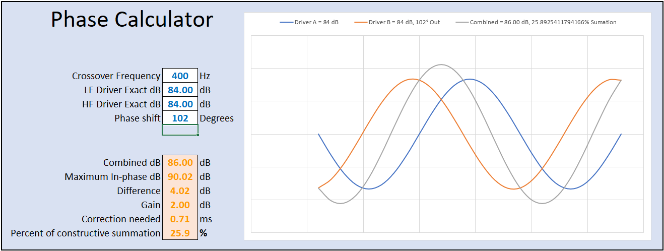

I like to use LR filters because they sum to 0. Other than the summation shown in the pic below, you can also see how far ahead of the crossover point the signal starts to roll off.
But, they only sum to zero if they're in phase. So, if you apply a 400Hz LR crossover (any slope) to your mid and woofer, and your mid measures 84dB on it's own at 400Hz, and your woofer also measures 84dB on it's own at 400Hz, and then you play them together you should now have 90dB at 400Hz... If they're 100% in phase at that frequency. If it only measures, say 86, I can plug that information into a spreadsheet I created to identify the delay needed to bring them into phase. Or, you can just tinker with the delay until you achieve the highest combined output.
You can see in the spreadsheet/calculator that the "84dB+84db=86dB at 400Hz" scenario indicates that they would be 102° out of phase and require a delay of 0.71ms to bring them to 100% phase alignment at that frequency. If the same scenario occurred at the mid/tweeter 2.5kHz crossover frequency, it would require only 0.11ms correction.
What the calculator doesn't tell me is which speaker needs the delay. Just have to try it on one and measure. If it's real close to 90dB, great, done. If not, apply it to the other driver instead.

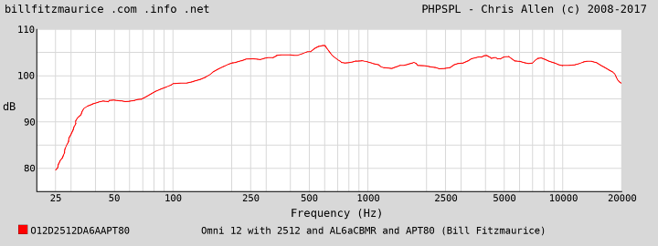

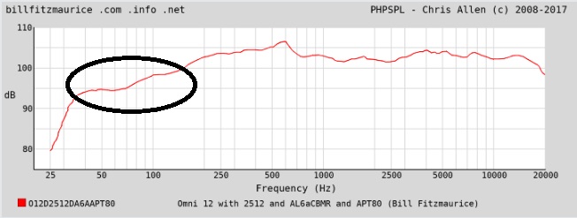

It seems like you're gonna have to choose between full bodied sound quality, maximum output, or a compromise between the two... or have multiple tunes that you can load depending on where you're using it. It would be great if you could just put a switch on it somewhere for that function, a tune switch. Me personally, if it were mine, I'd much rather it sound amazing with fat, smooth, luscious bass at a lower overall max potential volume than have it be amazingly loud and less full. It seems most of the Bluetooth speakers on the market today also choose SQ over SPL (more than likely, a balanced combination of both). They also apply a limiter. So, even at the maximum volume setting, they never go into distortion. That's my observation anyway. The target response curve I posted will give you a full sound, but will limit the maximum attainable overall volume before distortion occurs from the woofer amp channel running out of steam when there's more power left for the mid and high to continue increasing volume cleanly. (that's when a limiter is handy, keep it clean)
Which brings me to the next thing I wanted to discuss. I intended to wait until after it was tuned. But, since it's come up now...
The drivers used in the chart above aren't the exact combination you have, but the overall shape of the curve should be very similar.
The reason the overall output is/would be limited is; to achieve the curve I posted, the 50Hz region needs to be about 10dB above the average response from 100Hz to 16kHz. But, the speakers native response (chart above) at 50Hz is about 8dB below the 100Hz to 16kHz average response. Meaning 50Hz will require 18dB more volts/power than 100-16k when tuned to the target curve. The inverse is also true, 100-16k will require 18dB less volts/power than 50Hz. So, if given a signal with equal amplitude, and you have ±150 watts available for the woofer, the mid and tweeter are only going to require the equivalent of about 2.5w each. Doesn't seem all that impressive, leaving all that on the table, does it? Don't worry, music isn't equal amplitude and it should be plenty loud before distortion. But, what if you want more output? What if you want to take better advantage of the power available to the mid and tweeter and not sacrifice the bottom end to do so?
Psychoacoustic Bass tricks your brain into thinking it hears something that it doesn't actually hear by creating harmonics of a lower tone. Which could possibly double the overall perceived volume of your project speaker by removing the need to produce the signals that take a lot of power to produce and replacing them with harmonics in the portion of the spectrum that's more efficient. Maybe a little more than double perceived volume, up to 15dB, depending on how much of the bottom end you choose to keep natural.
