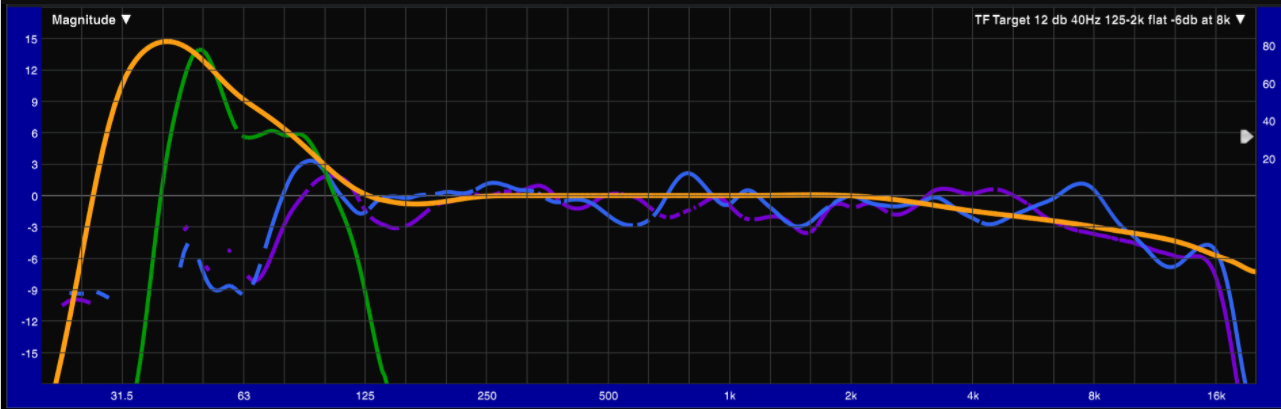

RYNO20 wrote: Sun Feb 07, 2021 8:35 am The crossover is very adjustable and has many slopes to select . I’ve been just going by my ears for selection.
I’ve experimented with the crossover and the equalizer, there is a lot there to take in.
I'd recommend penciling out a few different crossover schemes and trying/testing them all while taking written notes about changes and your impression of those changes.
My "go to" as a starting point has always been 125Hz on 24db LR filters. But, depending on the capabilities of the cabs, it could end up sounding better at 80, or 100... or 135.
Have you played with the auto EQ at all yet? Try it flat and listen to music. Try to set this as your target curve and see what you think.

My biggest enjoyment is the fact that I can have deep clean bass at such low power.
Isn't that great? You could probably only use half that amp (one channel) and never miss a thing.
